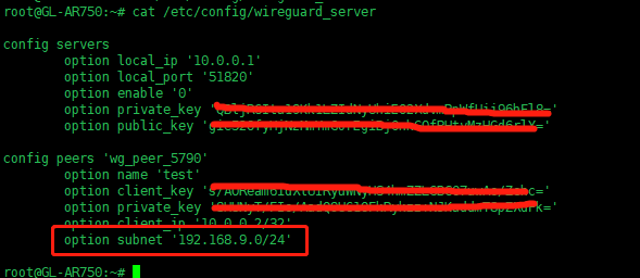

You can ssh to the AR750S(WireGuard Server), and add your AR750’s(WireGuard Client) LAN subnet to it. Please mind the LAN subnet should not conflict with server side.

Is it poosible to deine more than one Subnet at the Option “Subnet” in your first answer.
I have tested many versions, but no one works.
Regards
Christian
Yes, it can. It is a list option in uci, so you can add more than one subnet. But it depends on the topology in server side.
