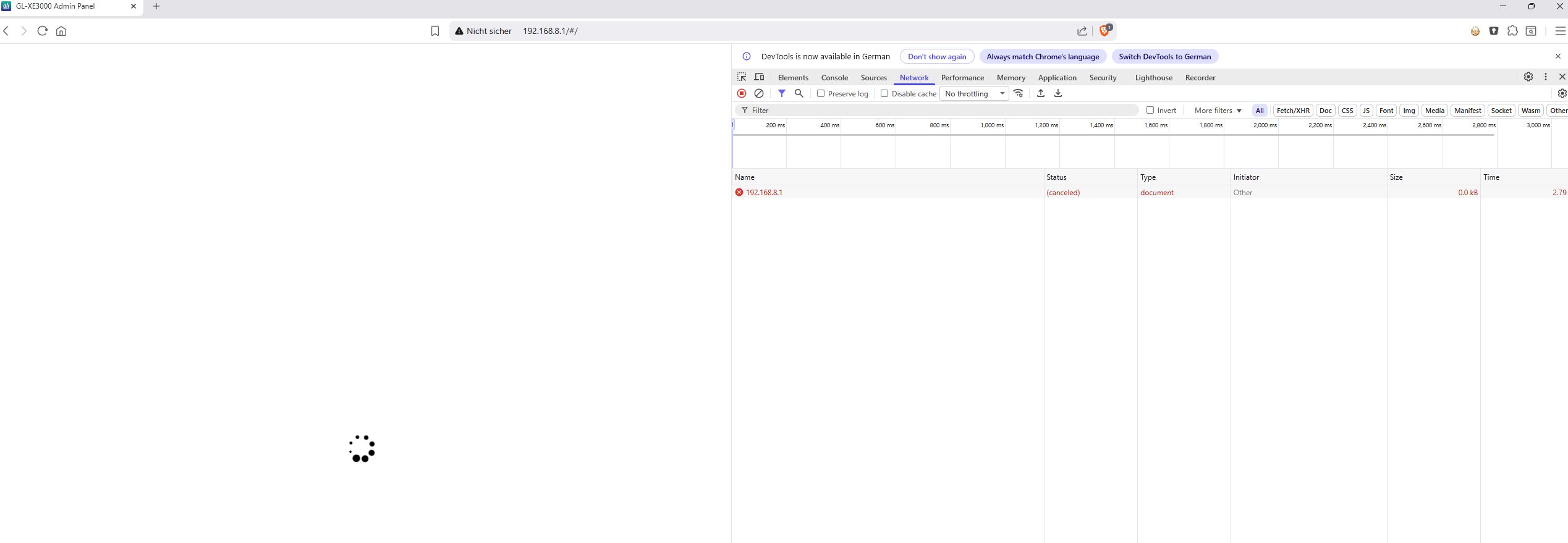

It's a bit odd—if Ping and SSH are working fine, then the WebUI should also be accessible.
Please try using a different browser or incognito mode to see if that helps.
If it still doesn't work, could you provide a screenshot of the WebUI so we can better understand what was happened?

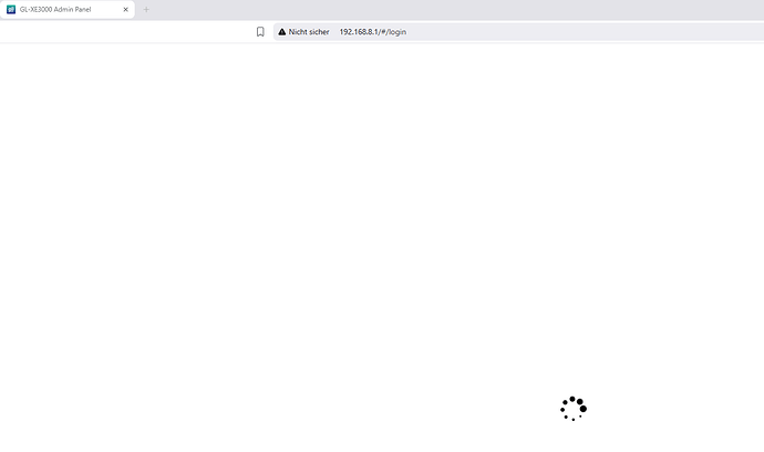

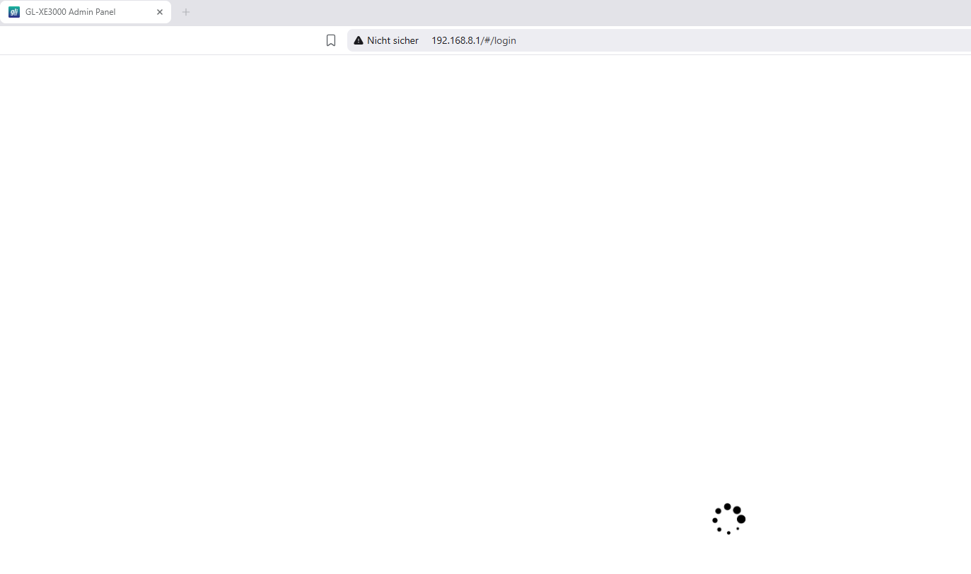

thanks again for your support. Yes really strange as SHH works but Web interface does not. As soon as Connect directly (VIA WLAN) to the router it instantly opens the WEB Interface. I tried with google and Firefox also in Private Mode. No chance. But what do you think about the error in ssh? I cannot add the route as mentioned above. Maye we are in a kind of asymmetric routing?
Here is a screenshot of the browser.
Thanks Alex

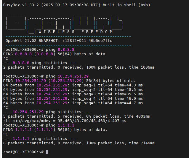

What I also see: I can connect via SSH - See screenshot. I can ping the Pfsense. But obviously no public address. So I think there’s a route missing.
Based on the provided screenshots, it appears that the VPN connection is functioning correctly, though the speeds are relatively slow.

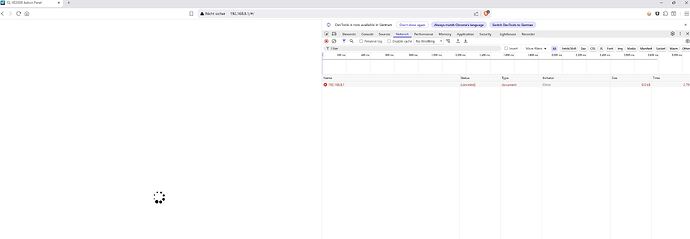

Please open your browser’s developer tools (press F12), navigate to the Network tab, and check whether any responses are coming from the XE3000.
Regarding the inability to ping the XE3000 via VPN after SSHing into it — this is expected behavior, as the router does not route its own traffic through the VPN.
To verify VPN connectivity, please run the following commands:
ping google.com -I wgclient1
curl --interface wgclient1 ipinfo.io
(Replace wgclient1 with the actual VPN interface name on your XE3000.)
