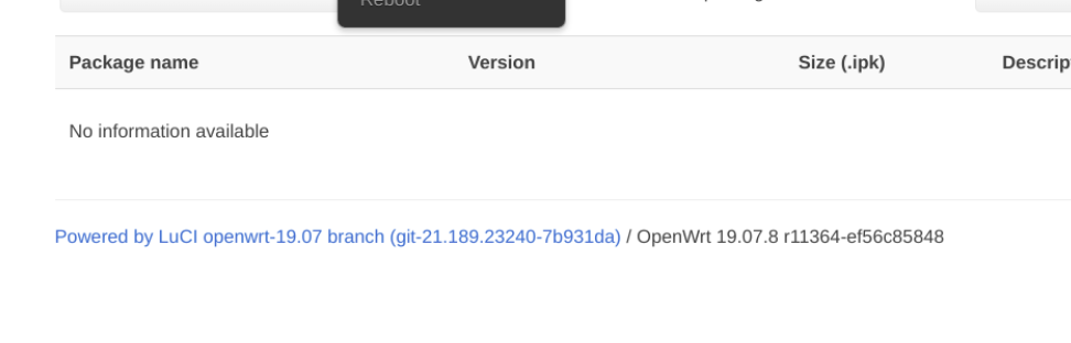

Edit: First question. I‘m running latest fw for my slate (3.216) which is OpenWRT 19.07.8?! The guide suggest updating to (at least?) 22.03.0.
I‘m not sure how to do that. Would sticking with 19.07.8 be an option, or is there a easy way to update?
Edit2: there is no tailscale release for my OS version

Looking closer to the picture in the guide, I saw these guy is running 19.07 too?!
Maybe I could just pick the Version for 22.03? Otherwise I would really be thankful for your help and really appreciate that. But I have to warn you, my linux and specially network knowledge is limited…
