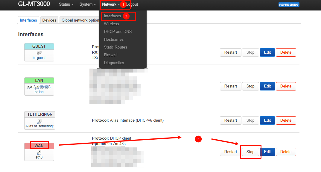

Alternatively, since you currently have a repeater available, you could try disabling the WAN interface under LuCI → Network → Interfaces and use the repeater connection instead to see if this resolved the issue.
