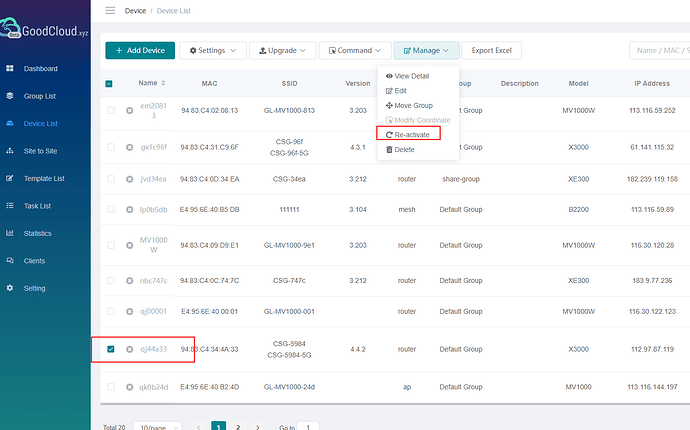

You cloud eactivate the device in the cloud.

Reactivate does not show up on my drop down menu under the Manage tab. I only get View Detail, Edit, Move Group, and Delete. How do I see those other tabs?
