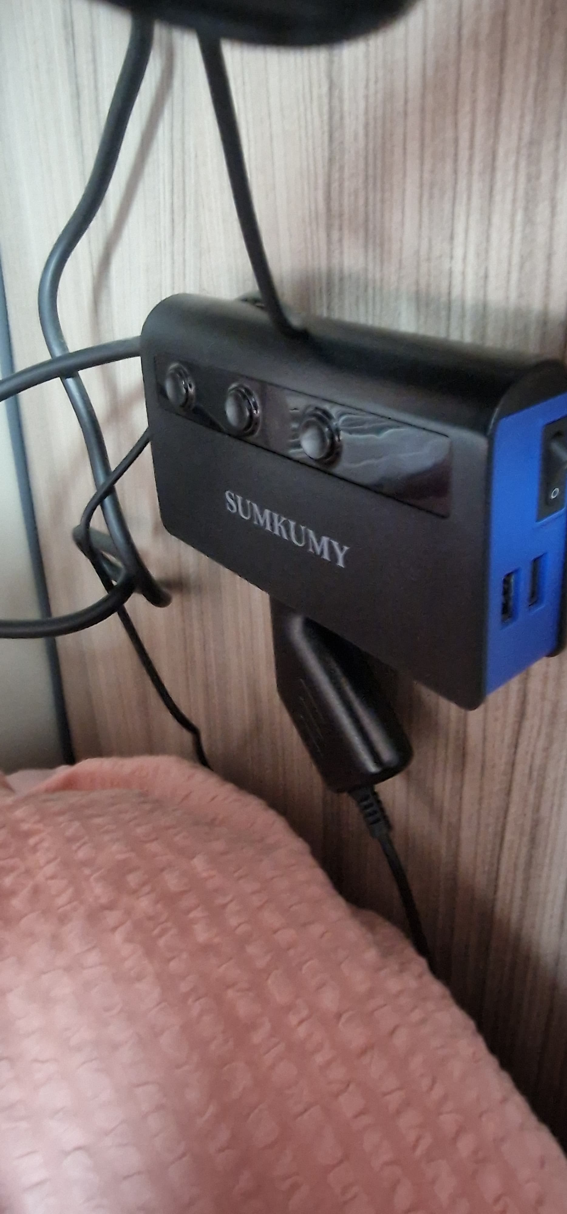

Its a RV so has a seperate 12v supply from Leisure battteries ,it is not from the vehicles 12v socket at the front,told yesterday to have a 12v 2.5 amp power cable,the 12v supply from the RV has cigarette type power female sockets, thanks
This is the 12v supply that has usb and Cigarette power sockets ,i want to run it from
It looks like this power adapter should be including a protection part, I think the router to get power from it, probably a little better than directly from the cigarette port.
