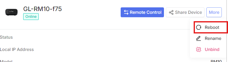

I also sent a command to reboot the KVM, and got a notice “Reboot command sent failed”
connected to the network? A lost or unstable connection could explain both the 2FA prompt disappearance and the failed reboot command.
If possible, could you also try restarting the device through the GLKVM App and let us know if that resolves the issue?
maybe you can export log to us.
I attempted to restart the device via the web interface controls and it would not respond – I don’t use the application, only web portals.

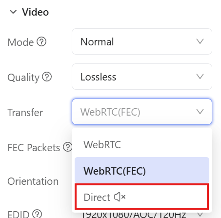

As luck would have it - the ipKVM just locked up again… forcing a manual power cycle (cycled POE power, using the GL-iNET POE splitter for this unit). When this happened, I was unable to select DIRECT instead of WebRTC/WebRTC(FEC) – @flora72 - sending you the logs
