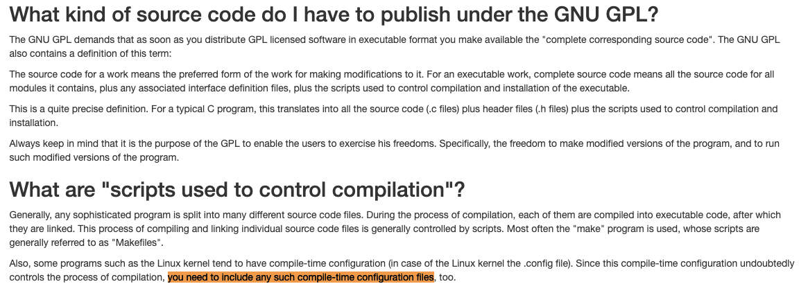

GL.iNET, Kernel is GPLv2, which basically means โ€˜if you distribute binaries, then you have to distribute sources to let anyone build a kernel by themselfโ€™.
Please, share kernel configuration file.
I was examining all the feeds earlier, all the repositories involved are GL and keyed.
Opkg list installed gives a 6.6.47 R1 version for most packages.
I don't need their code (even if they have to open it by GPL rules). I need only configuration file that was used to build kernel, without configuration it is unable to compile any other module.

I don't know what else I should say to GL.iNET, please read about GPL:
