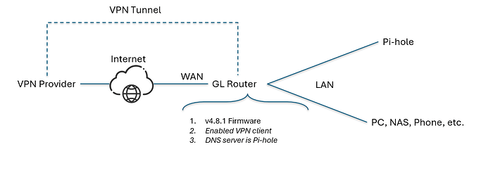

I would like to know about your network topology, as well as the related configuration of the router, including VPN, DNS, etc.

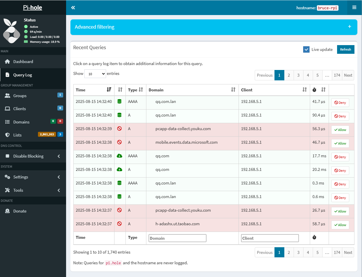

As I did not reproduc this issue on my MT3000(v4.8.1 snapshot, 0815).

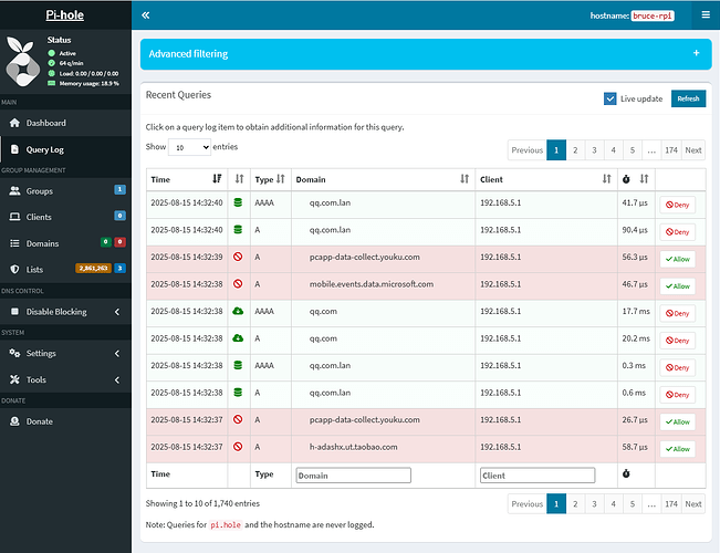

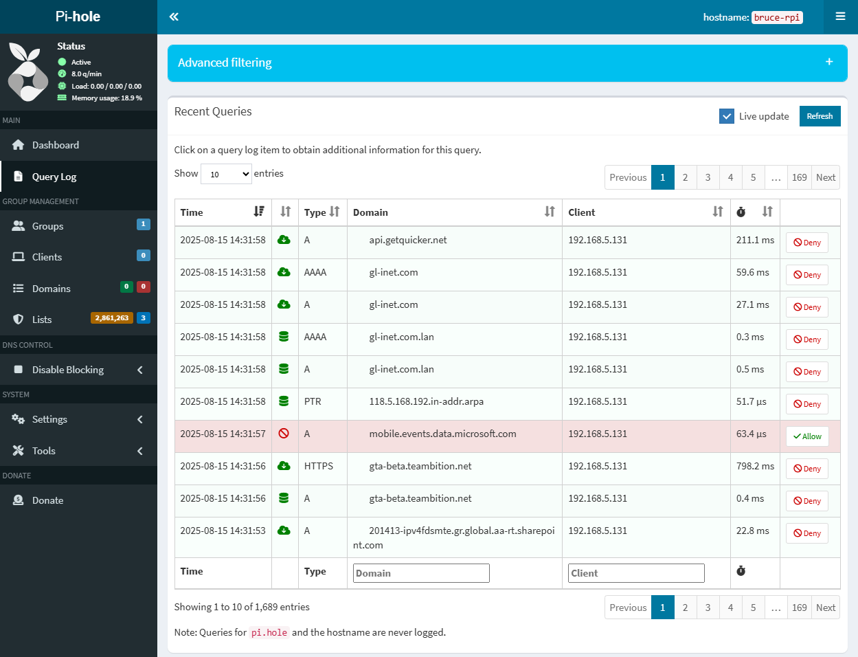

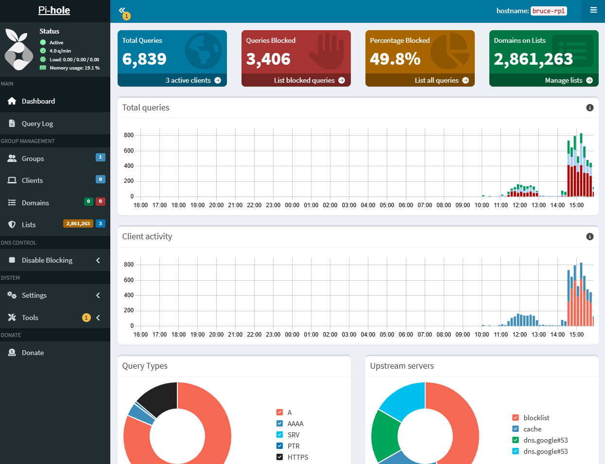

My test environment:

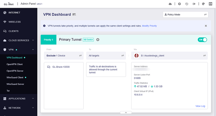

The router VPN client is enabled:

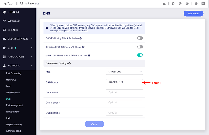

The router DNS server is customized as Pi-hole IP.

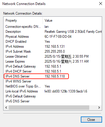

You can also customize the DNS server as Pi hole IP directly on the client's network card settings. Of course, if client's network card settings not changes, let the DNS server as the router IP (i.e., gateway). DNS requests of client will be sent to router, and the router sent to the Pi hole (but there is only one gateway for the Pi hole client.)
Regardless of any of the above methods, when router VPN client is enabled, through the Pi-hole log, all LAN clients can resolve normally through Pi-hole DNS server:
  1. Customize the DNS server as Pi hole IP directly on the client's network card settings
  2. The router DNS server is customized as Pi-hole IP, and all clients DNS server is router/gateway IP

May I know what is your router VPN Dashboard configuration?
Sure, I don’t know exactly what you are looking for but here’s a screenshot (I was only allowed one). The deal is having the OpenVPN connected on the router means I can’t reach anything on the VPN or the internet. Turning it off and everything works again
