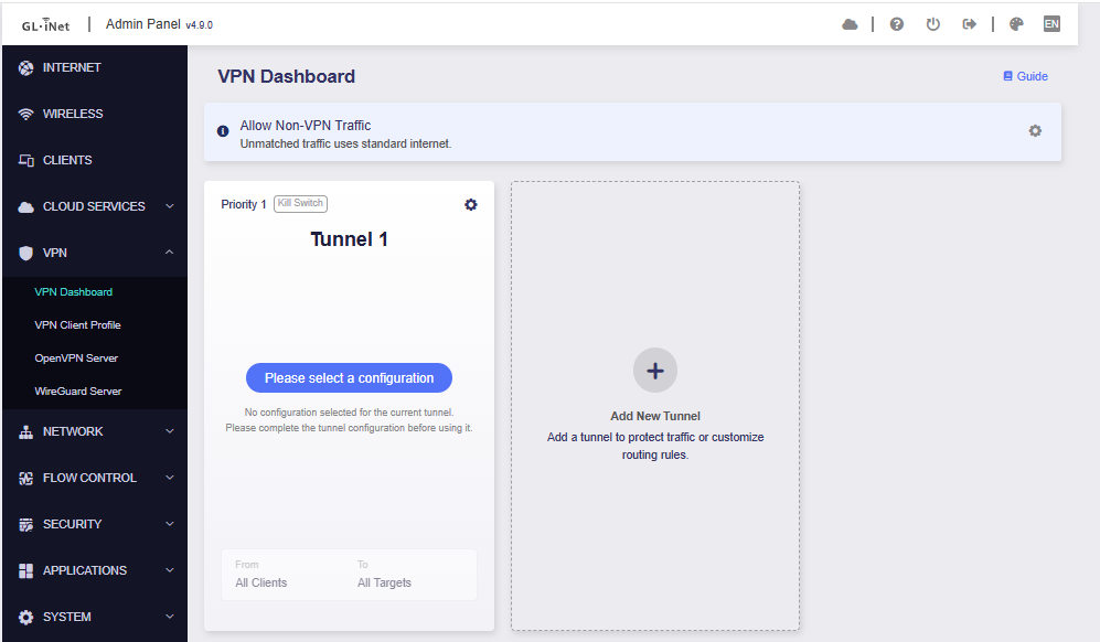

Reproduction: disconnect the tunnel, go to the VPN client profile and add one more server to the existing group via the server selection (ca1214 in my case). Back on the dashboard, Tunnel 1 shows "Please select a configuration" — the entire tunnel configuration is gone.

We were able to reproduce the behavior where an existing tunnel displays “Please select a configuration” after the NordVPN server list is updated or another server is added to the provider group.
When the provider server list is updated, the related provider profiles are refreshed, and the configuration previously selected for the tunnel is cleared. The corresponding tunnel and routing rule therefore remain inactive until a configuration is selected again.
This is the current expected behavior. The tunnel itself has not been deleted;
