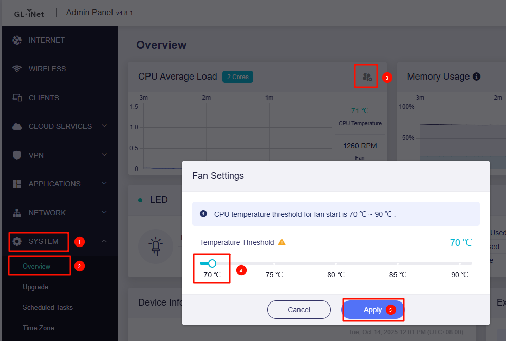

Alternatively, you can lower the temperature threshold that triggers the Beryl AX’s fan.
Please note, however, that this may lead to increased fan wear over time.
