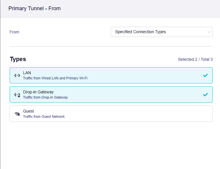

For your particular use case, we may be able to simplify the setup slightly. For example, rules 4 and 5 could potentially be merged into:
“All zones except Guest use the VPN”
(In this case, the Guest network would naturally bypass the VPN, while all other connection methods would go through it.)

Scratch that, it doesn't work, and I think I tried that to start with. You can't do all connection types excluding guest as far as I can see on 4.8.1. If you specify the connection types to include, you need to select the ones you want to not route via VPN and specify no VPN as otherwise they get caught by the ‘all other traffic’ toggle which I want set to off. However, this breaks the ‘all other traffic’ anyway as this appears to use the Primary Tunnel policy including if this is set to route not via the VPN. I might still be able to squash my policies a bit some other way but I must use specific exclude policies as the alternative is too error prone and fragile, particularly for devices that like using randomised MAC addresses (sure you can turn off randomised MAC per WiFi network but again a simple WiFi config change on router or client and that all falls apart). Also, keeping policies robust and easy to understand (hard to inadvertently screw up) is super important. I can't see myself needing more than 5 VPN clients on the router, but at the moment I can really only use 2 with my desired exclude policies based on domain, device and connection type and that isn't really sufficient. For my particular use case more sophisticated policies may help, I'll take a look at 4.9 at some point.

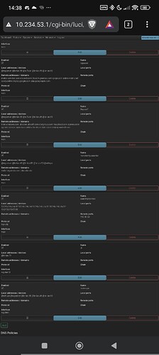

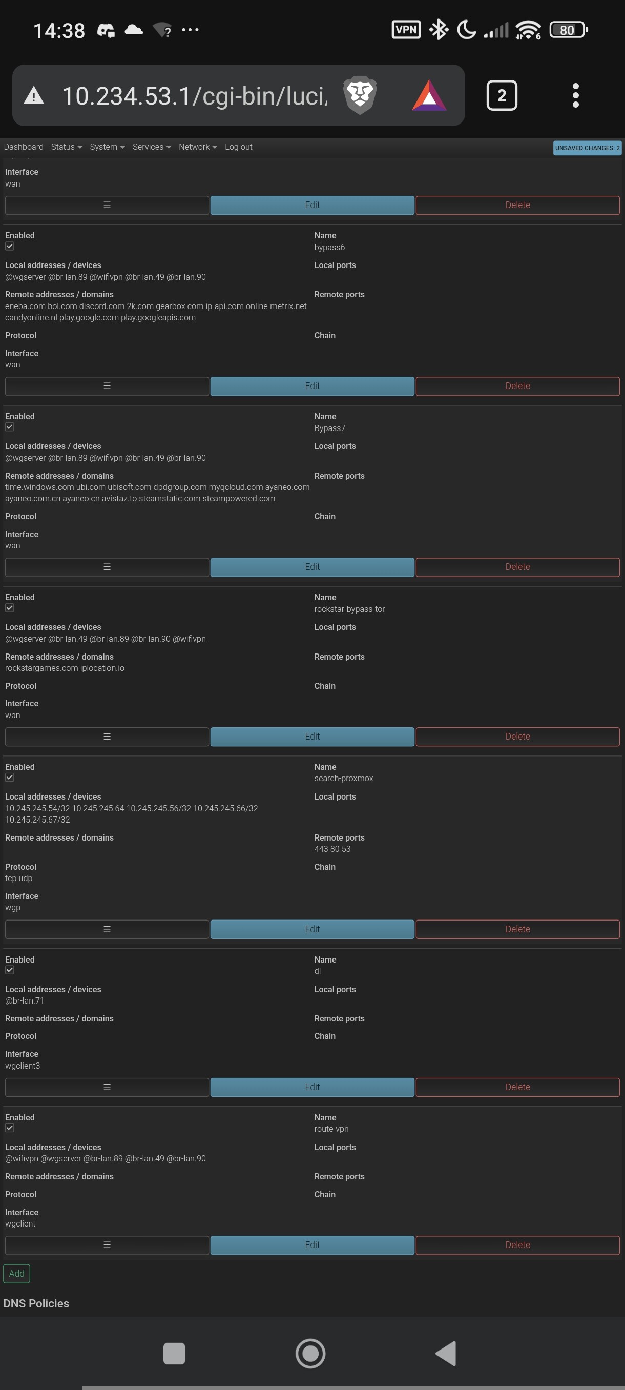

Then you can take a example of this screenshot how to define policies:
Note that when you want multiple wireguard clients in vanilla OpenWrt with the same key, you just create the same interface as wgclient, only the peer here is important to be different and in such way you can route the peer differently but feels a little inconvient, but it is fine.
Make sure that peers do not have 'Route Allowed IPs' checked only for wireguard server this is needed, pbr replaces the full routing.

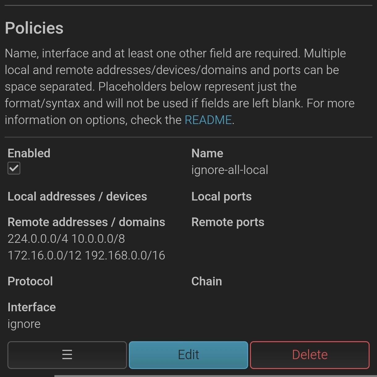

And to allow local clients to not get kill switched in advanced settings inside luci-app-pbr you have a checkbox to show the ignore target, then add src range with the target ignore :slight_smile:
See this example:
