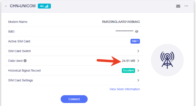

I’m on a XE3000, but I can’t find this traffic statistics page. Updated to the latest version as of today.
Any clue where it is?
If your XE3000 has updated to v4.8, click on "Data Used" under the cellular section to view the traffic statistics.
