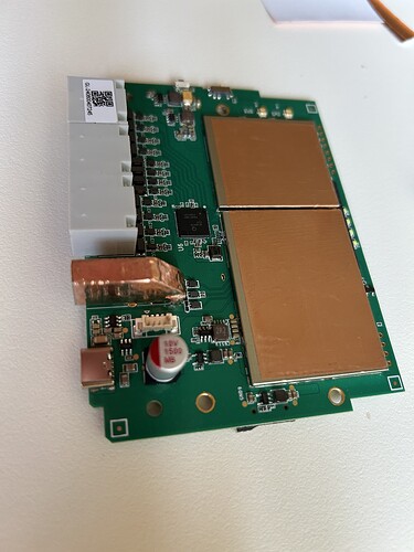

I got myself copper tape/foil and started applying inside my router. An hour later I was done.
The end result was a huge improvement and as much as +150Mbps!!
Before I started the project, I also verified the issue, by connecting my laptop to the router with a cat6 cable and moving large files on to my little NAS drive. For the record, this router can write on to an HDD, an average of 95MB/s via lan cable. This is with an Intel based MacBook Air, via USB adapter to Lan.
Via a wifi, Im now averaging 60MB/s. But before using copper tape, the average was around 40MB/s. So that’s a great improvement and link speed on wifi doesn’t drop by 300Mbps and bounce around, as low as 480Mbps.
Last few words. I applied 3 layers of copper tape around USB 3.0 port. It took some time but I got it there. It works well with 3 coats, but I should have gone with 5. Maybe this weekend ill take it apart and add more layers of copper.
I also added two layers on the covers that protect the CPU and WIFI chips. Did it do anything? Ehh…Maybe? I would love to take them apart and cover on the inside as well.
Engineers at GL.iNet, if you are listening, this I very cheap fix and a must one.
Last but not least, I have attached a few pictures. :grin:
