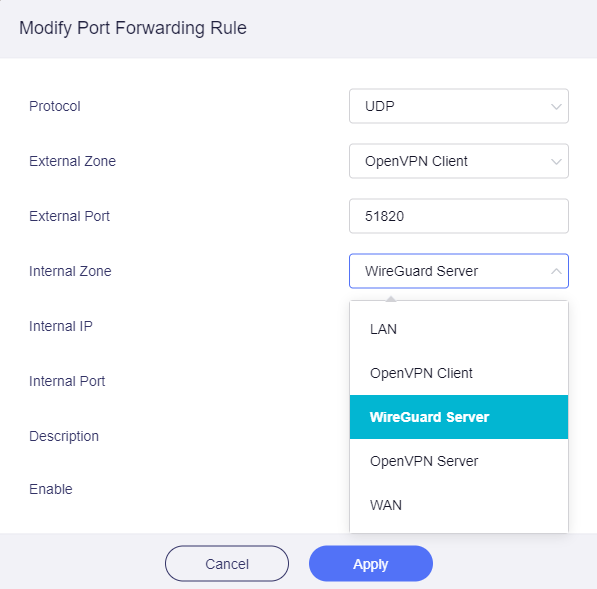

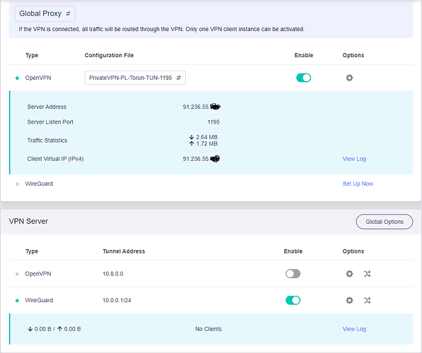

Here the settings, do I have to add portforwarding? What exact settings?
Thank you
I send you a message. I need to test.
