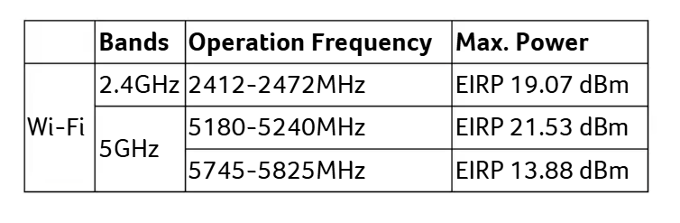

  2. Here is what the technical manual says.
This only info that the manual states, nothing else.
RF Channel: 2.4GHz & 5GHz: Auto
Security: 2.4GHz & 5GHz: WPA2/WPA3
