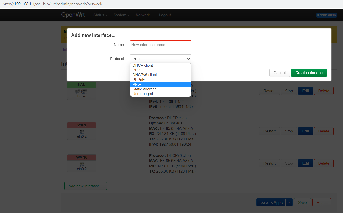

Next step I did was added the kmod-pptp under the system software. It also installed three other pieces to it (part of the pptp package). I rebooted AR750s. Then when I go to the add a new interface under Luci, I don’t see the pptp as a new interface. What do you suggest.
In latest openwrt, go to software, first Update list, then install
Install kmod-pptp and luci-proto-ppp luci-mod-pptp
Reboot the router and you will have pptp in luci
