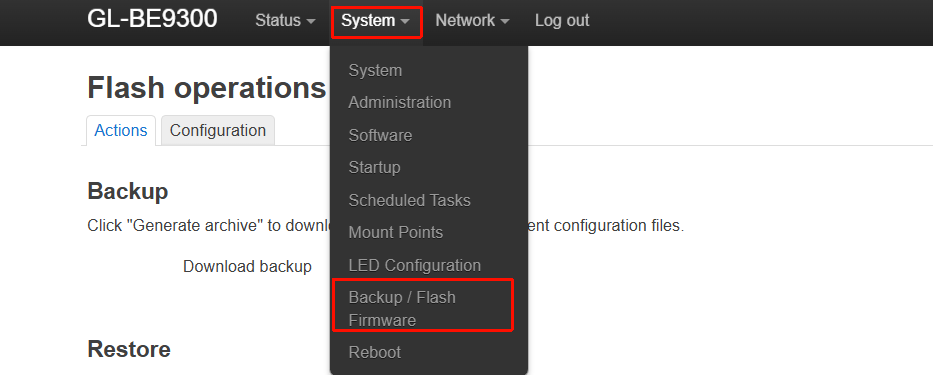

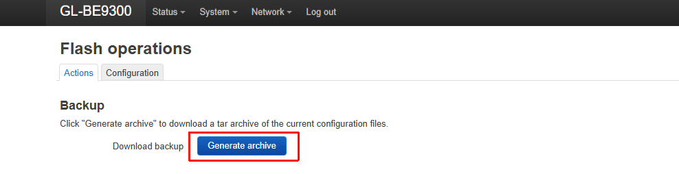

If GoodCloud access cannot be provided, could you export the LuCI backup file and send it to us via private message so we can import your configuration for testing?
The backup file can be exported from LuCI → System → Backup / Flash Firmware:
