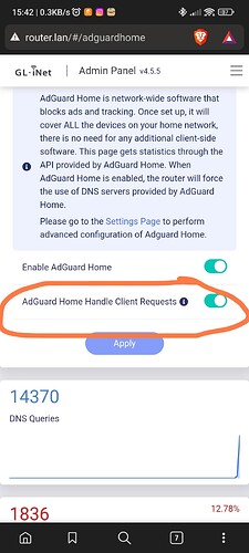

Hello I enabled adguard also enabled the option to see the clients ip address in adguard. But it’s not working.
Any advise.

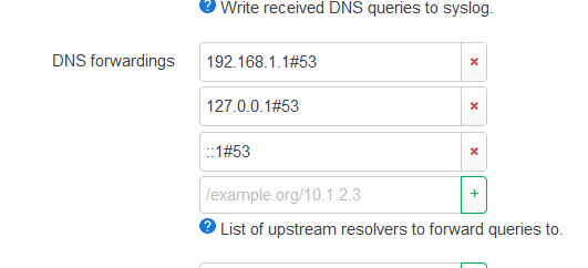

Do the devices use the router as DNS server or do they use another?
They are using router as the DNS but I want to use adguard as DNS server directly

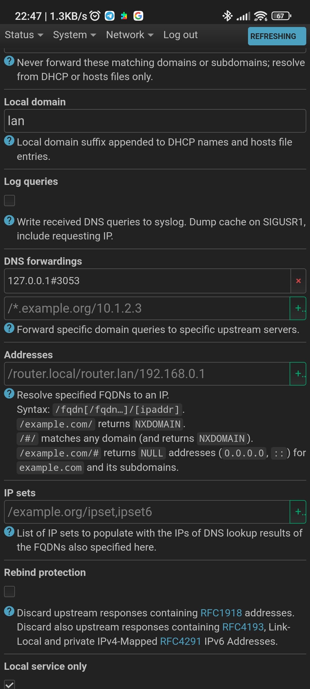

in luci i have redirected to adguard after moving dnsmaq to port 54
and disbale use isp dns in wan
