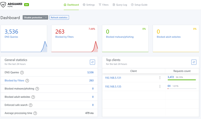

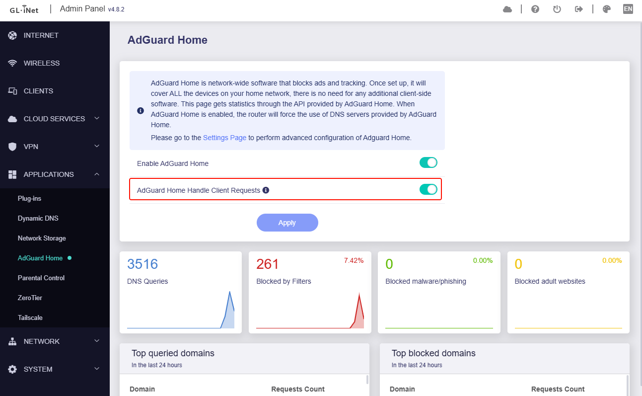

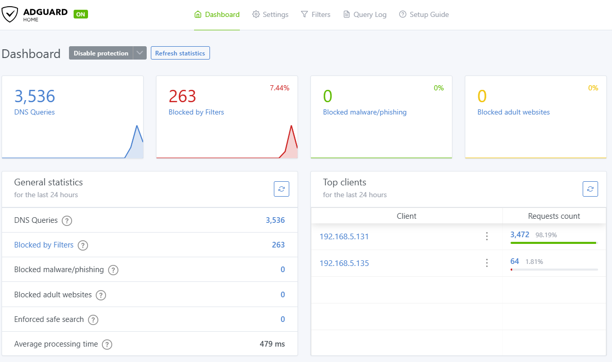

Please manually upgrade the AX1800 firmware to the latest one which currently firmware is v4.6.8 stabe or v4.8.2 beta:
When the upgrade is completed, there will be an option: Adguard Home Handle Client Requests
