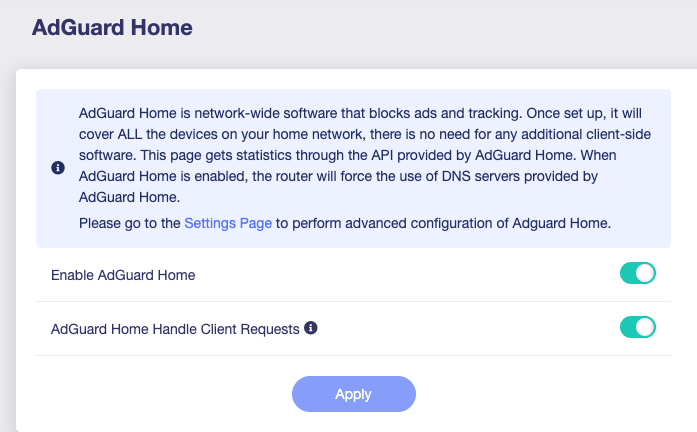

Hi, I have a new GL-MT6000 (Flint 2) running v4.8.3. I had everything working and decided to update Adguard Home to the latest version. I did this through the Adguard executable on the router (ssh’d in) as well as one of the scripts a mod here created. In both cases, the upgrade worked fine, but I noticed that while Adguard shows as running, nothing is actually being blocked or processed by AGH. I get an “empty” dashboard in both the GL-iNET Admin Panel as well as AdGuard Home’s site. I have tried different tricks like removing the config.yaml file to force it to generate a new one from scratch. I am not seeing any sort of errors or overlay errors on the AGH page. It’s just silently failing. I have tried manually flashing the same 4.8.3 firmware, choosing to save settings. I made sure to enable AGH from the Admin Panel as well as enabling “AdGuard Home Handle Client Requests”.

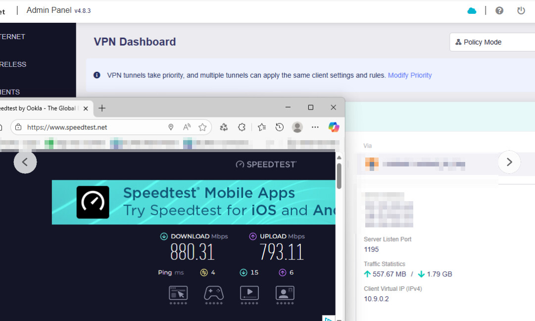

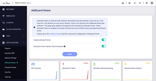

We ran some tests on Flint 2 with version 4.8.3 and were unable to reproduce the issue.
For ADG Home:
Fresh install, only set up for Internet, enabled AdGuard Home and "AdGuard Home Handle Client Requests"
ADG Home runs normally:
For VPN:
Regarding the ADG Home issue
Please share screenshots of Application - AdGuard Home and Network - DNS with us so we can better understand the your DNS-related configurations.

For ADG Home:

  • DNS and AdGuardHome screen is as you’d expect
Toggling DNS Rebinding and Override DNS doesn’t fix ADG not working
