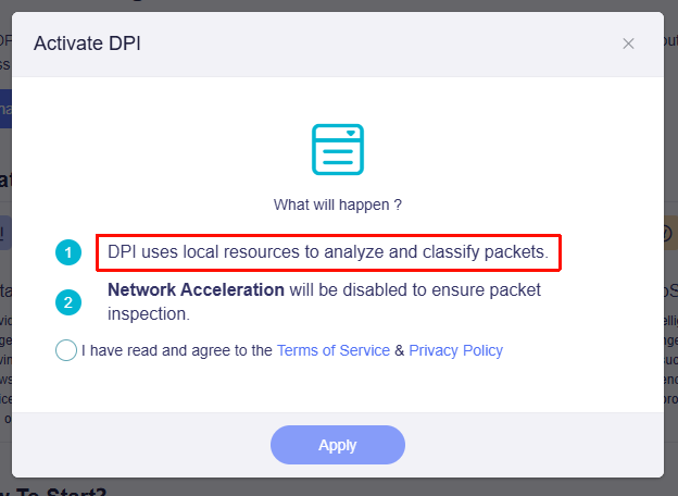

I really like having these amazing features available, and I’m curious about how they interact when both are enabled in the new beta firmware. Do they operate completely independently, or does one content blocker/filter take precedence over the other? Any insight would be appreciated!

AdGuard Home filters at the DNS level, while DPI operates at the IP packet level.
They work independently. However, since DNS queries occur before accessing a domain, AdGuard Home filtering typically takes effect first.
All data is processed locally and is not uploaded to Netify or GL.iNet.
