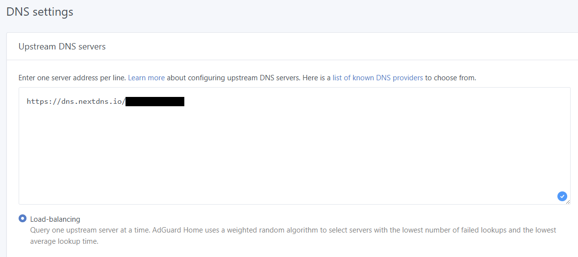

I’m testing Adguard Home on my Flint 3, firmware 4.8.4. Using a NextDNS upstream server using DNS over HTTP / HTTP3. Everything works fine by default.

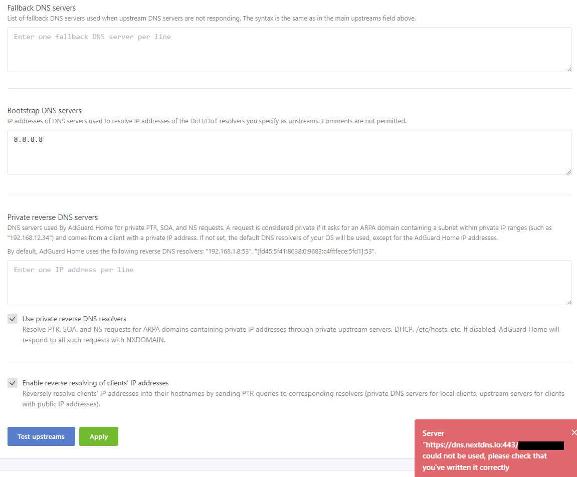

It seems AdGuard can’t reach the upstream servers, which the “Test Upstreams” button confirms.

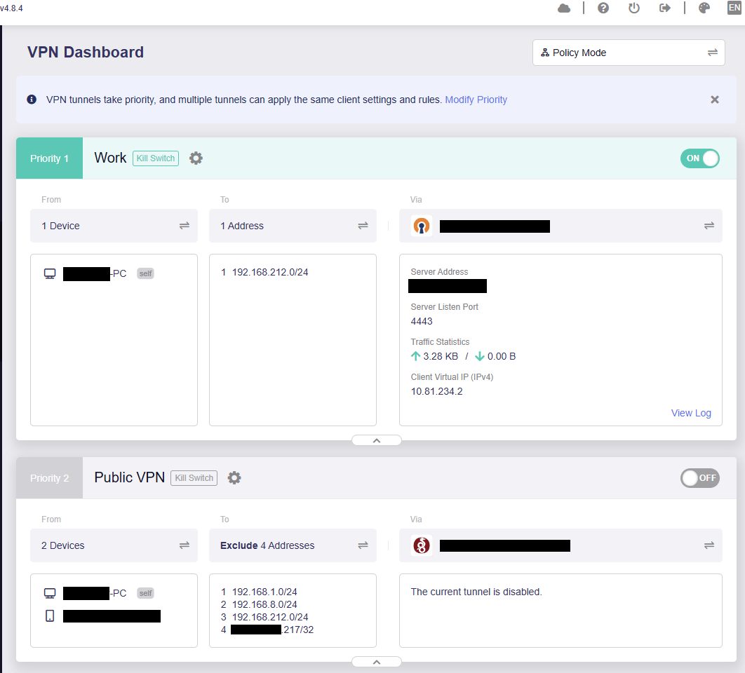

VPN configuration that breaks DNS:
I’m only routing my work computer and the corporate subnet through the VPN (Include mode). As far as I understand, this should not affect AdGuard.

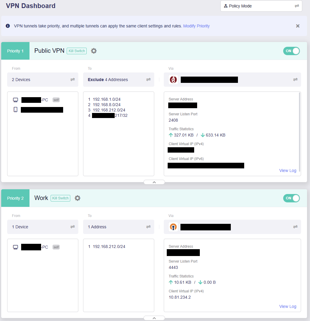

I tested some more and moved my public VPN provider’s WireGuard VPN (Exclude mode) in priority higher than the work VPN and turned it on:
DNS resolution works again. As expected, DNS resolution is now sent through the VPN.
If the public VPN is turned off while still highest in priority, AdGuard breaks again, so it doesn’t seem to be related to the priority alone.

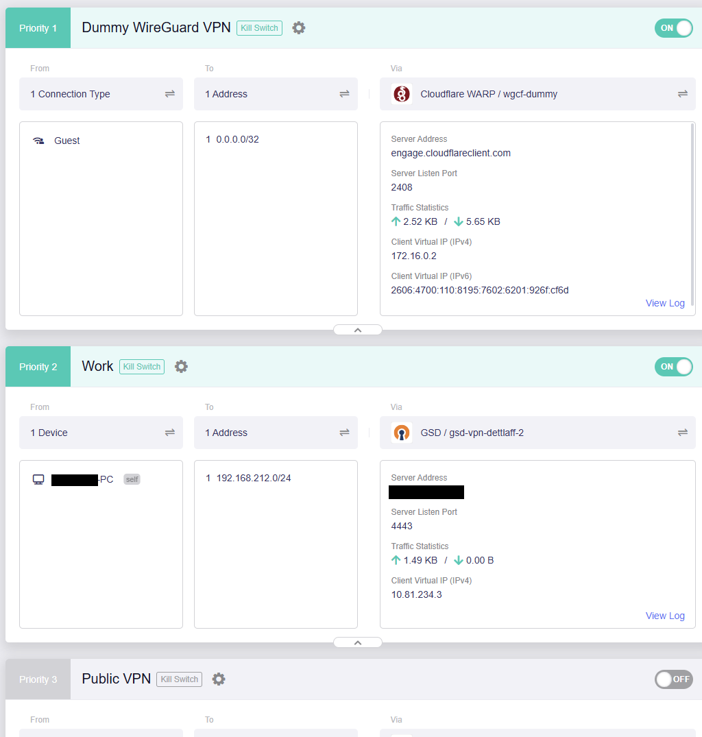

Now it gets strange: putting a dummy VPN on top, which doesn’t actually route anything (guest network doesn’t exist + Include mode with invalid IP):
AdGuard works again, as long as the dummy VPN is connected. So I can use this as a temporary workaround.

Notes regarding AdGuard’s “Test Upstreams” button:
Work + Dummy VPN + DNS over HTTP = OK
Work + Dummy VPN + DNS over HTTP3 (H3) = FAIL (but so far DNS is still working ~ 1 hour)
Lastly: This issue doesn’t happen when AdGuard is configured with unencrypted DNS. However, I require to use DNS over HTTP for my config.
