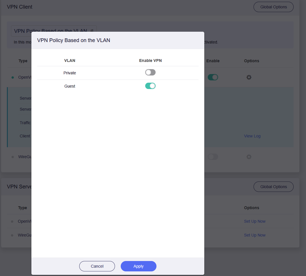

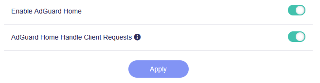

i have VLAN based VPN client activated on my Marble router. When activating Adguard Home, at first everything seems to work. My private VLAN clients access internet normally and the guest VLAN clients access internet over VPN.

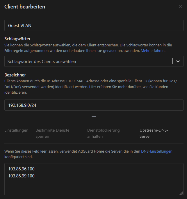

When i look on the Adguard Home Web UI there are no DNS requests though. I also activated VPN DNS server as upstream DNS in Adguard for guest VLAN.
In my understanding guest clients should use adguard but use VPN DNS server and VPN should work (which it does). Private clients should just use adguard dns but this seems not to work. When disabling VPN, Adguard immediatelly gets DNS requests.

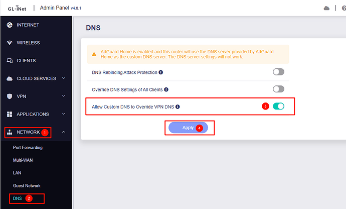

Please try upgrading the firmware version to latest beta version 4.7.15 and enabling the option: Network → DNS → Allow Custom DNS to Override VPN DNS.
The latest firmware can be download here and you can upgrade it according to this guide.

I have to correct myself, something is strange. Everything is fine with VPN. My Guest VLAN is using custom upstream DNS, i have no leaks and i'm recognized in the correct country.
But the normal (private) VLAN is odd. The requests are processed by Adguard, but DNS leak test shows a server from different country (VPN location). Upstream DNS is quad9, so i guess the nearest quad9 is used. But why the VPN location? My private VLAN should not use VPN.
