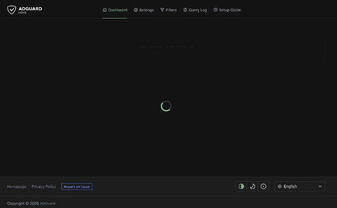

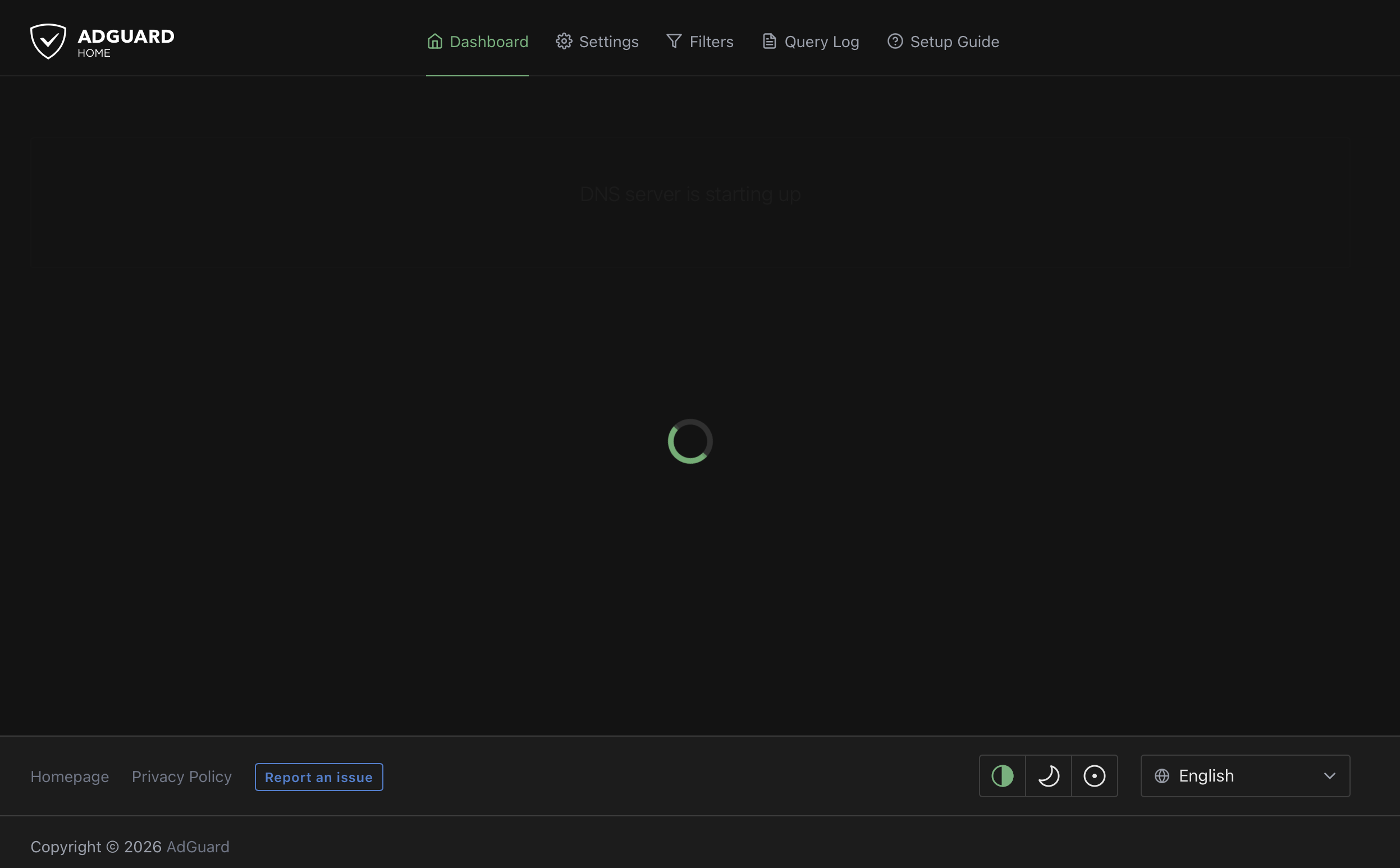

Adguard on my GL.iNet GL-MT3000 router won’t start at all since two or three days ago. I just noticed that I can’t resolve any website on all my devices connected to the router.
When I checked, I found out that turning off Adguard Home solves the issue.

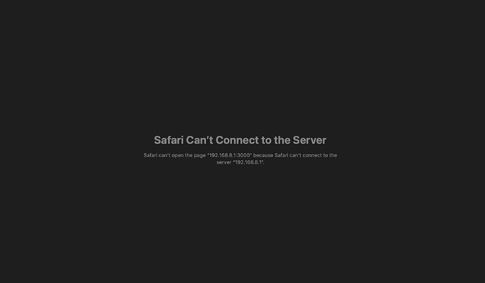

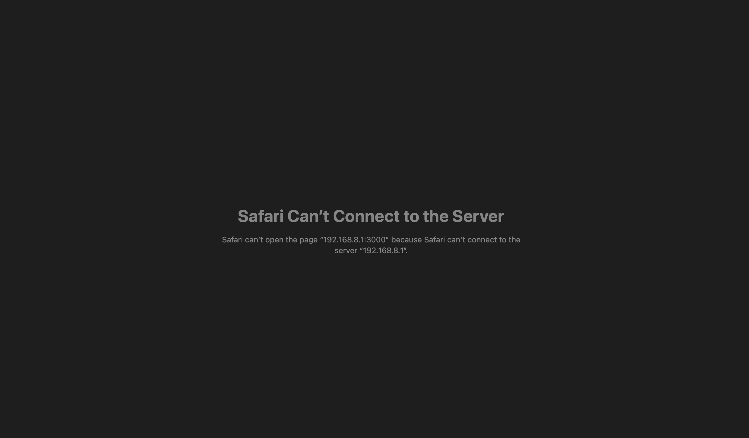

Now, if I turn it on, Adguard won’t even start.
After a few seconds..
