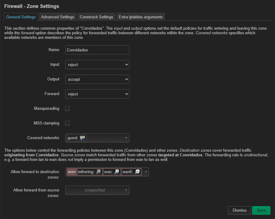

  • I attached a screenshot of the guest firewall zone.

When I look to the screenshot you made for the firewall zone: Convidados.
I see that input is set to REJECT, turn this to ACCEPT and save and apply. :+1:
changed the guest zone input to ACCEPT as you suggested, saved & applied and also restarted services. Still no Internet from VLAN 1.10 — clients get DHCP and can reach the gateway (192.168.9.1) but cannot reach WAN.

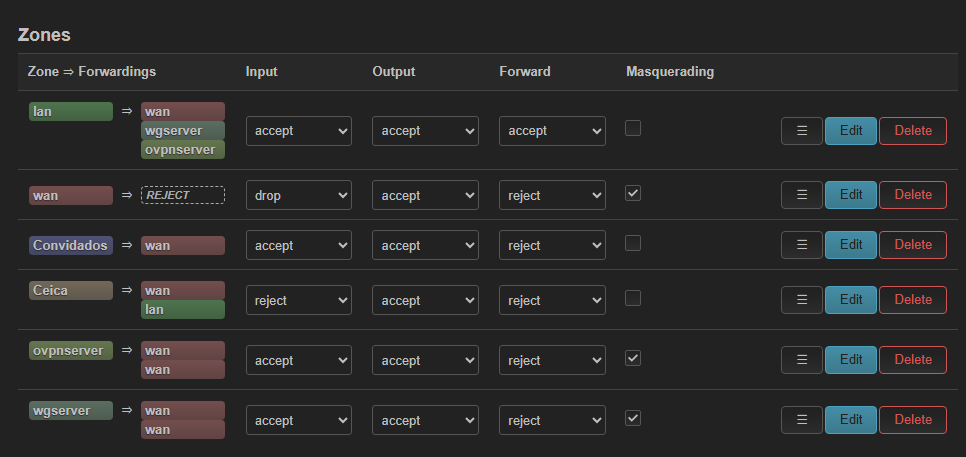

I attached a screenshot of my current Firewall → Traffic Rules and Zones (the rules image). Any suggestions on what to check next?
weird, normally if input is set to reject clients will not receive ip from the dhcp server from the router, however it is possible you are on a static ip then it is possible there is no inbound traffic since there is no arp communication or dhcp ack/req communication.
traffic rules on the other hand have a higher priority on top of zone forwardings, it could be a left over traffic rule which make it work?
All the other things seem to be correct in your firewall configuration now.

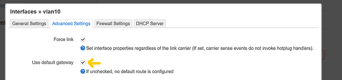

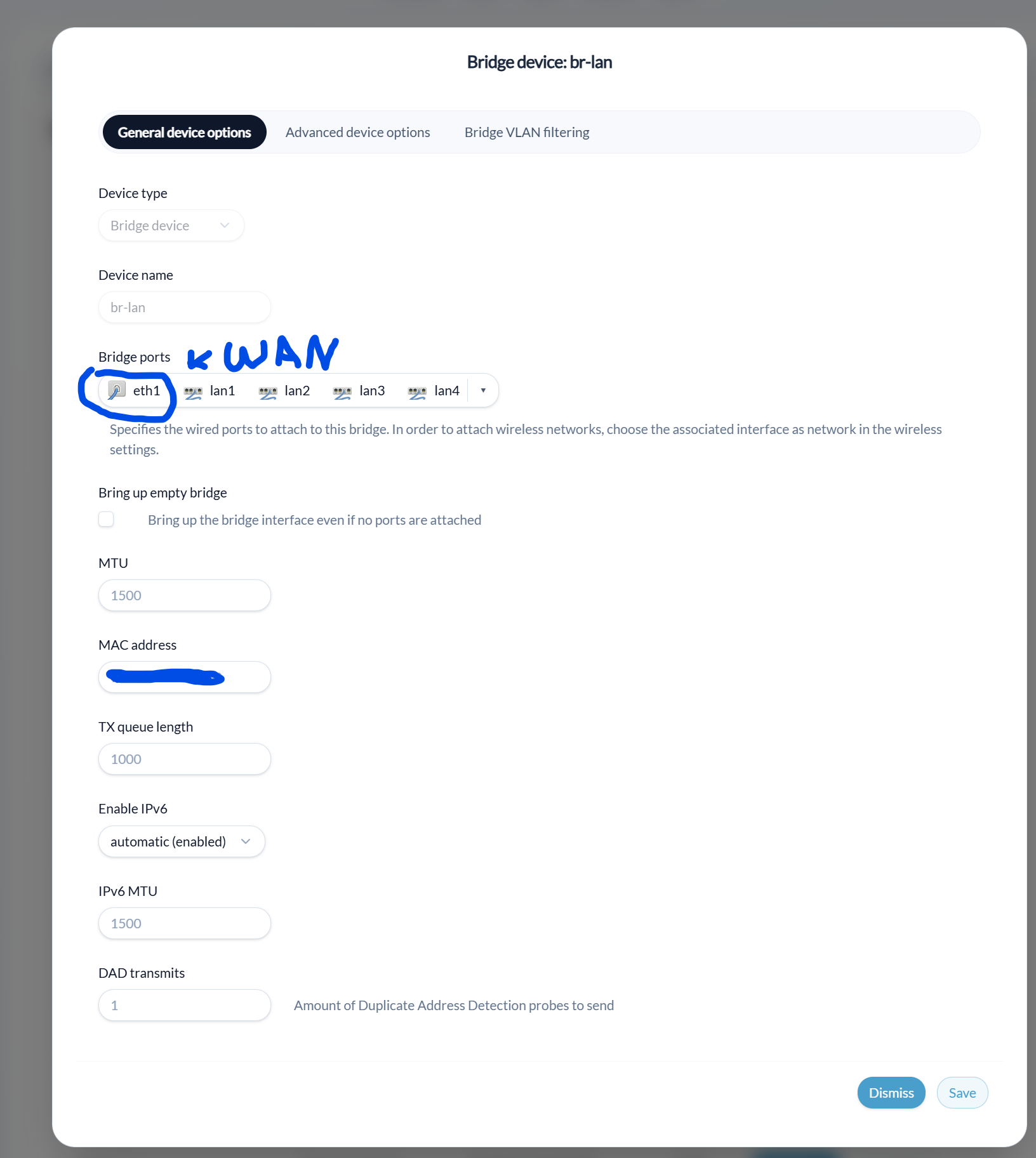

ah, now I see what your intentions are, forgive me for sending you to the wrong tutorial :slight_smile:
this is your secondary AP, and you want to receive vlans from a other router, correct?
so far I don't see huge issues but something what requires attention but won't be your direct issue:
when I look to:
you are missing unchecked default route:
change to this:
config interface 'guest'
	option proto 'static'
	option netmask '255.255.255.0'
	option ipaddr '192.168.9.1'
	option device 'eth1.10'
	option igmp_snooping '1'
	option ip6prefix 'f266:6b75:4eae::/48'
	option ip6assign '64'
	option ip6hint '0001'
	option ip6ifaceid '::1'
	option ip6class 'guest'
    option defaultroute '0'
config interface 'CEICA'
	option device 'Ceica'
	option ipaddr '192.168.30.1'
this reflects in luci on:
the reason is, that this checkbox only should be checked on interfaces which would present wan like structure, you may want to use this only on lan if you want to form this as gateway (managed vlan) to access remotely.
as for the other options, well I could only advise to use lowercase since Linux also is very case sensitive but as for now this won't help your issue.

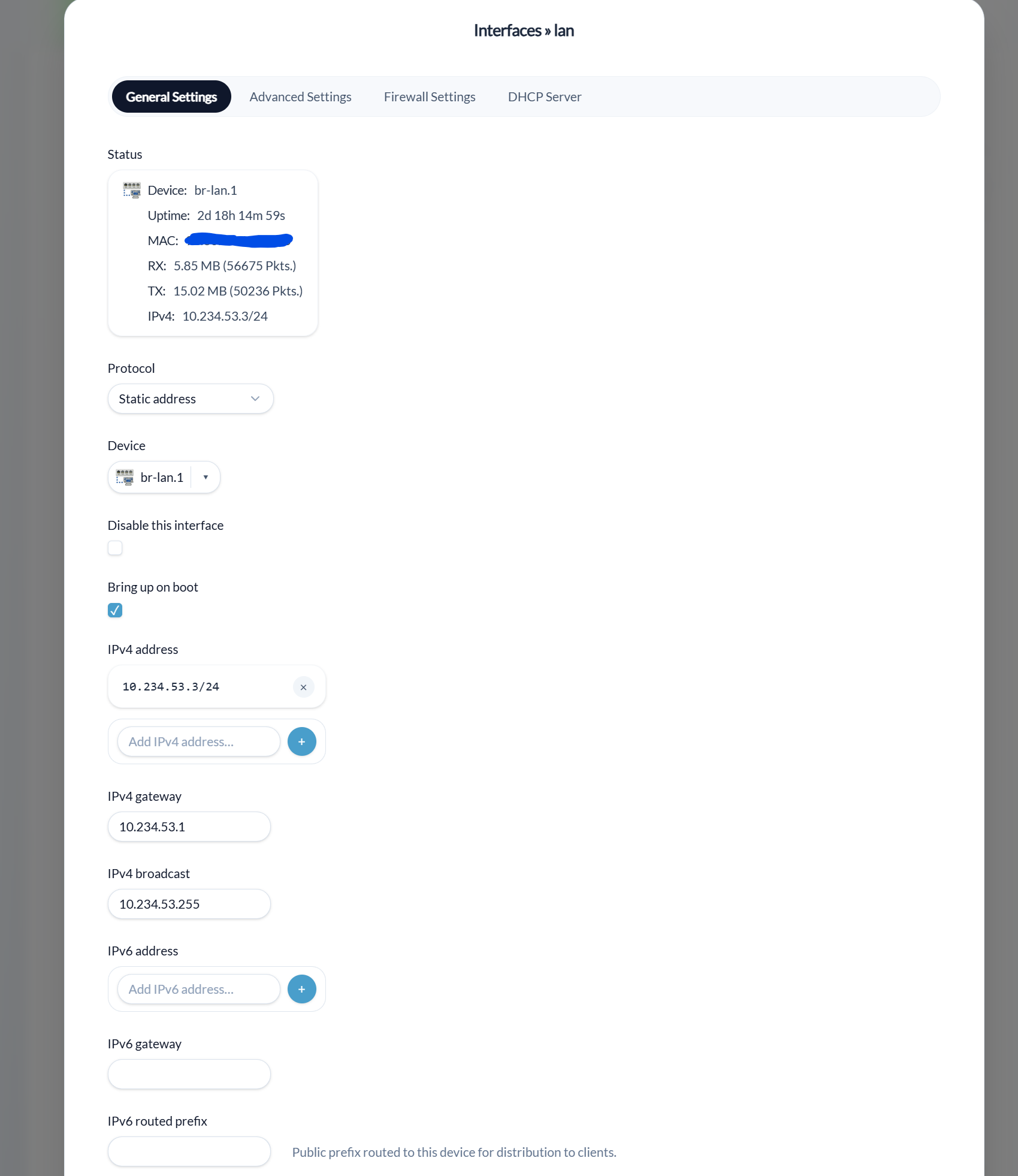

instead what I suspect what your current issue is, is that your upstream switch, you already said unifi, is using the same ip, which has a habbit to turn both down (an ip conflict), I do know this from my own experience :stuck_out_tongue:, you might want to consider to put the AP on a much higher static ip range, you could make the router static by doing this through the upstream router, or make the interface static.
here is one way to do it on such interface on my currently dumbap:
^ lan is my 'wan' in where I also access remotely due to the nature of a dumbap there is no firewall, of course your config is not aimed to a dumbap, but this image will show how to make it static.
and my br-lan has this because yes this will be a little confusing otherwise when seeing br-lan :slight_smile: :

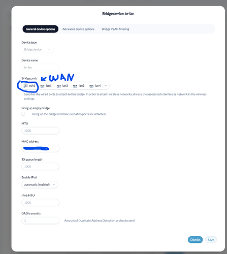

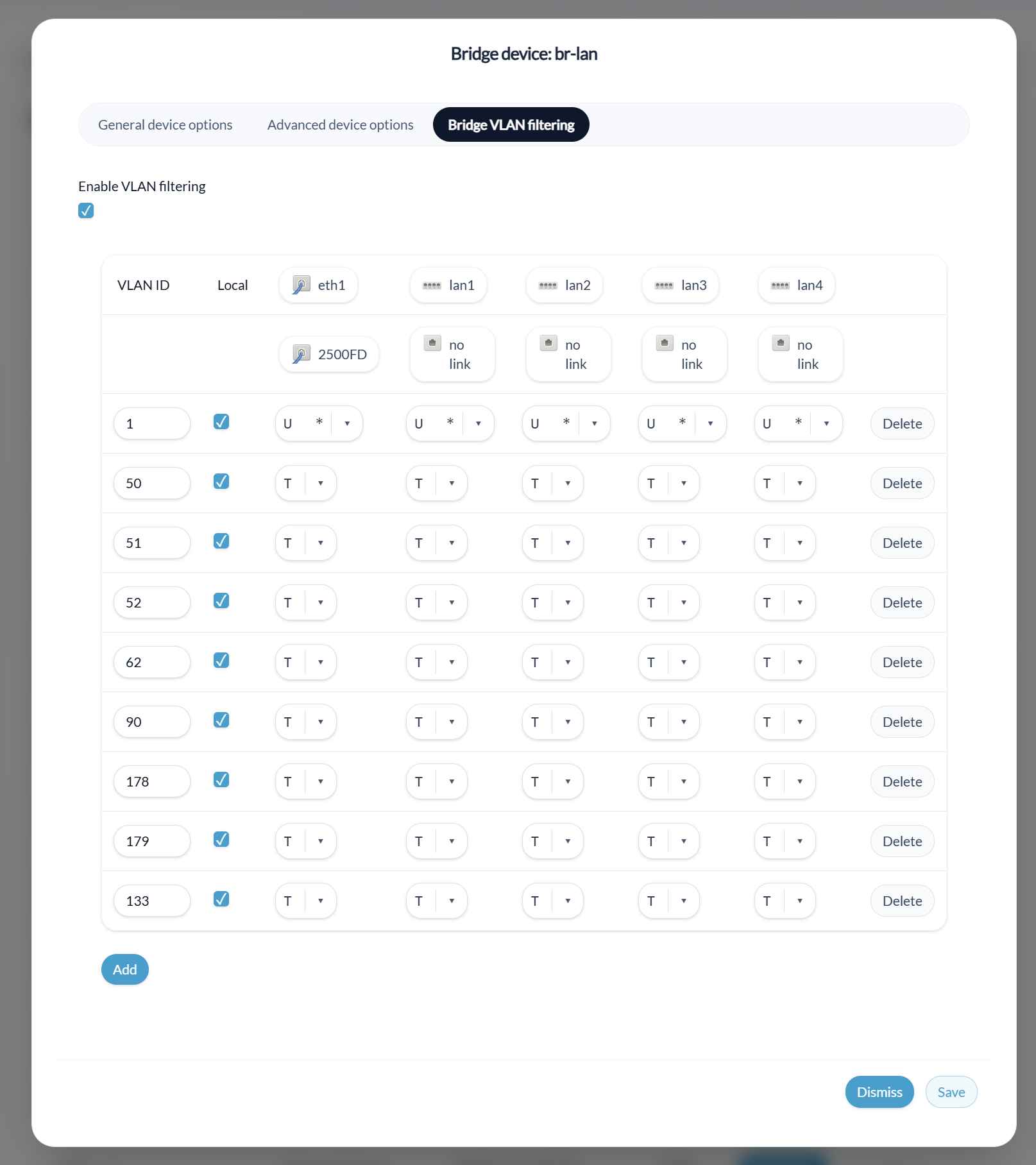

and then I tag things like:
eth1 is wan port, and this must be always tagged to upstream, except for the default lan, this way you can have both wired and vlans on a secondary AP with dhcp clients.
also when doing such configuration, I would recommend to use lan port to configure your wan as being part as lan to avoid buggy behaviour with applying and failing, I myself thought a long time it was not possible :wink:
Hi @xize11, thanks for the detailed guidance and for catching the default route issue!
I applied your suggestions:
  • Added option defaultroute '0' to both guest (now labeled Convidado) and CEICA interfaces in /etc/config/network.
  • Confirmed my UniFi AP is tagging VLAN 10 correctly (same setup as the working CEICA VLAN 11).

How is the firewall configuration can you sent me this one?
  • /etc/config/firewall
