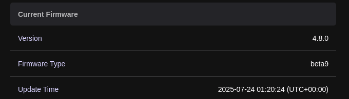

I have a Slate AX currently running v4.8.0-beta9 (after flashing back from OWRT-SNAPSHOT) which I'm auditing before I begin testing,^1 a Flint v1 that needs flashing over pure OWRT-SNAPSHOT once I get the time to do so, a Certa (a discontinued GL.iNet travel router — a very small unit!) configured to use GL GUI from a 16GB microSD for its primary storage instead of the puny onboard 16MB flash that I really should get updated, too.
I'm currently using Stangri's PBR ATM on a wired-only router running OWRT 23.05.5 I keep on hand in 'in the lab.' I'm going to do some through testing of GL.iNet implementation to check for leaks, etc. Even then I doubt I'm going to put the Slate AX's v4.8.0-beta9 into prod. I'm just going to get it all reviewed, make some suggestions/bug reports, pull a backup of the confs, then wait for a stable release.

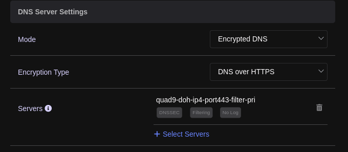

... with all WAN-side traffic in a VPN tunnel? That pretty much mirrors my DNS setup, sans AGH, using Quad9-filtered DOH instead of ControlD:
$clientDevice -> [ Slate AX -> DOH -> Quad9-filtered => VPN ] ==> WAN
