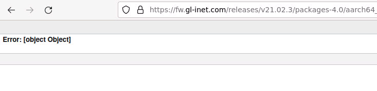

I tried to install a package recently and message appeared
Failed to update repository list, please check your network and try again.
I then tried to connect to this URL and get Error: [object Object];
https://fw.gl-inet.com/releases/v21.02.3/packages-4.0/aarch64_cortex-a53/packages
Is the repository down ? I was able to install packages a few weeks back.
Found the cause of this and it really seems stupid to me.
I did a factory reset and still not working, did not load refresh the package list via web ui.
Then I tested in terminal, opkg update worked fine.
Lastly I check my firewall, and added a rule to allow port 53 to 1.1.1.1 and now it magically worked in web ui as well. Is there some hardcoded DNS setting in Applications->Plug-ins that doesn't care what your DNS is set to in DHCP ?
