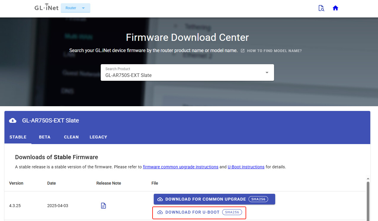

Can you flash GL firmware through uboot mode?

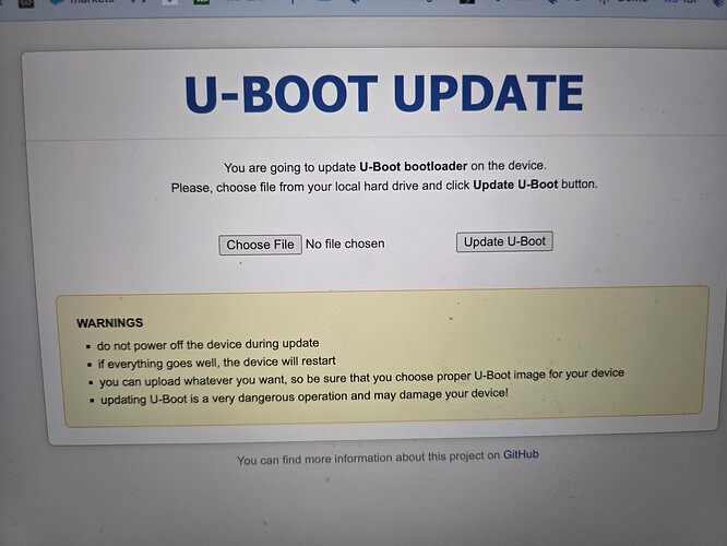

I was able to get to uboot but not able to flash any firmware

Have you tried these firmware in uboot?

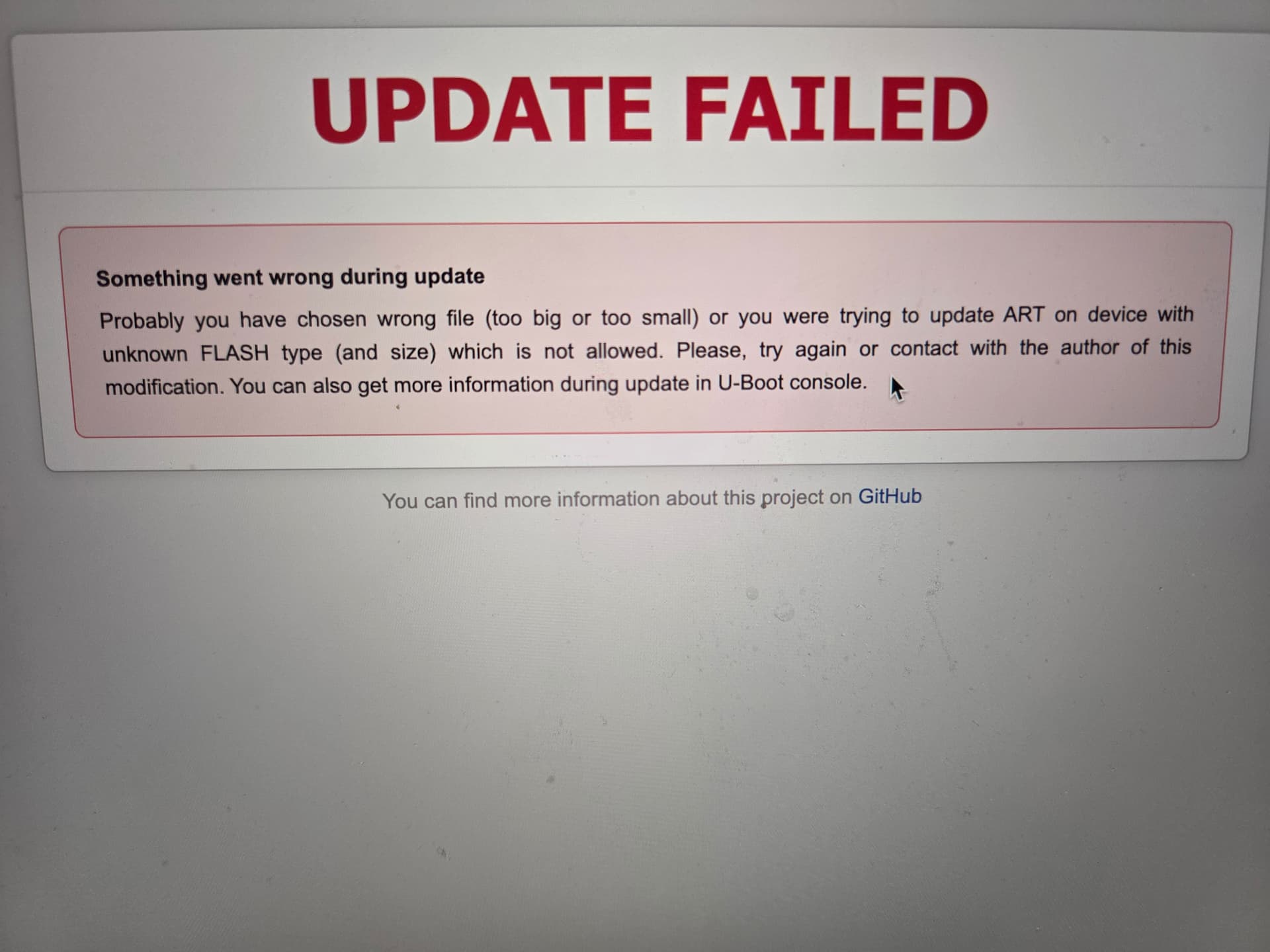

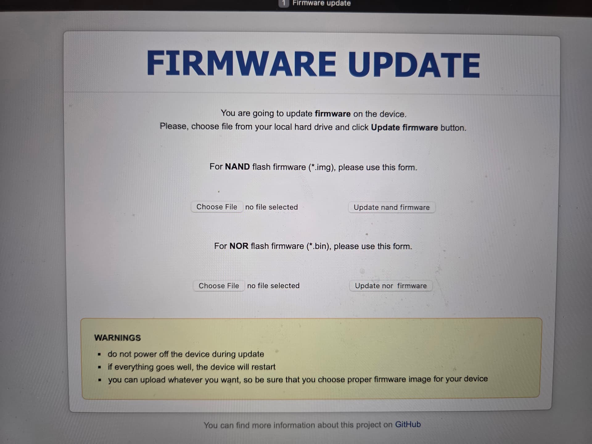

Showing different uboot page in safari vs chrome but unable to update .bin file
Please ensure the URL of the uboot you are visiting is http://192.168.1.1 not 192.168.1.1/uboot.html
Please flash the firmware in NAND, and select .img firmware
