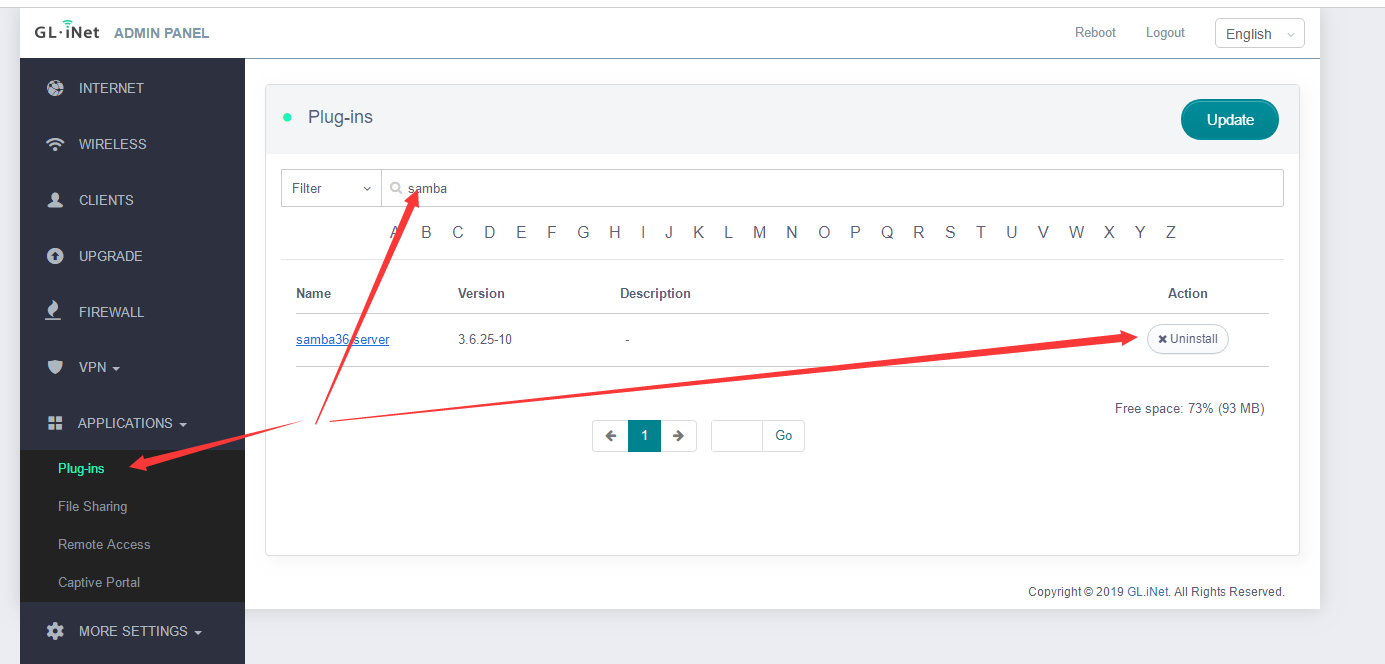

Yes, This is ssh command and you can remove the samba package according to the screenshot below, and reinstall it if necessary.
