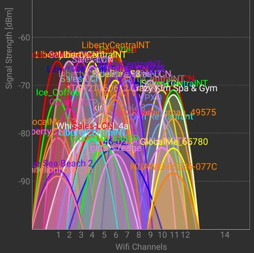

Standing on a street corner in downtown Nha Trang, Vietnam :slight_smile:
How does the 5ghz band look?
That photo was maybe a year and a half ago. There wasn’t much 5Ghz around at all, in fact I did scan the 5Ghz at the same time, with NO 5Ghz connections available. Most people just use the modem supplied by the internet company unlike say Australia (and probably other countries) where people buy their own modems to “supplement” the ISP service to get better WiFi speeds or more stable performance or 5Ghz band… Commonly found was ISP supplied units like the ZTE F606. No 5Ghz band at all.
The consumer shops tended to have small, cheap routers from say TP-Link or Tenda and it was very rare to find one that support 5Ghz, and the price for these was much higher than a cheap 2.4Ghz only units (N300 or N150)
Internet there was pretty good…when it worked. The speeds were pretty up and down. I read reports how the “sharks bit the main feed cable” maybe 4 times in the year and a half I lived there as the reason why internet was so slow. :slight_smile:
