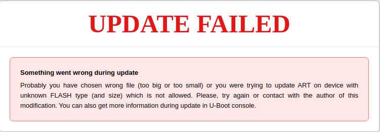

Have tried the 3.104 and if I try the 3.104 adguard image I get:
I do believe that before I tried to reflash the wifi SSID it came up with was GL-AR300M-XXX-NOR if that means anything.
