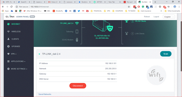

is this what you wanted?
I am having the problem again with or without the vpn being connected. It is definitely your router.
Now you have vpn enabled. We’d rather want to see when you don’t have vpn enabled.
