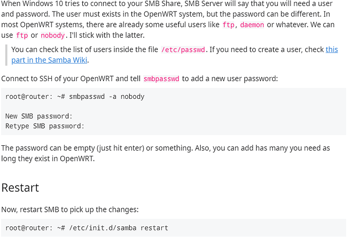

I have another question, I activated smb2 protocol from ssh as the guide on Gl.iNet website says and file sharing works well with Android. However, Windows does not allow guest access. So, I tried to change the settings again via Putty ssh according to this guide that i found here in the forum :
The problem is that when i try to prompt /etc/samba/smb.conf.template it tells that I don’t have the permissions to access. Actually even if I put only /etc the situation is the same.
is that normal? how can i manage to connect windows without changing lanman settings in Local Security Policy.
Thank you!!
By default you cannot change files on the router via SAMBA.
You can just use winscp to do that. SSH to the Router - GL.iNet Router Docs 3

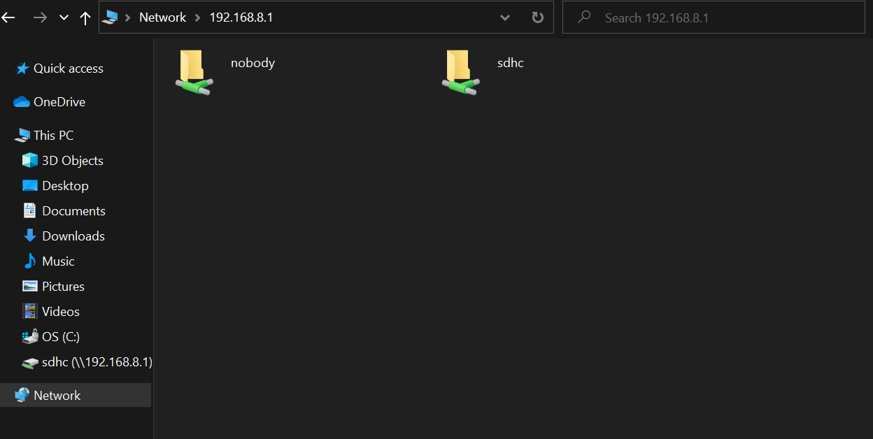

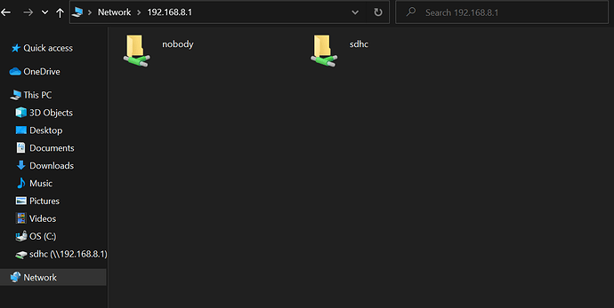

I’ve managed to create a password for the “nobody” as the guide suggested.
However, when i map the drive, together with the Sd card i see also this folder.
is it normal?
Thank you!!
