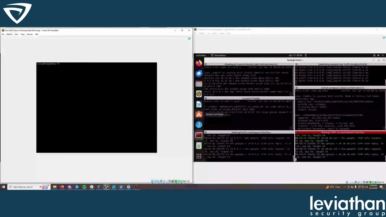

I read this article today (in German, need to translate to English via Chrome):
There seems to be an issue with DHCP protocol, allowing to set routes via DHCP, which would compromise any VPN on the router, because it would bypass the VPN gw.
Here an English article about it:
I would ask Glinet support to look into the issue, and work out a fix for this issue. Glinet mobile routers are advertised to use in open WLAN like hotels, and have VPN protection. This issue would bypass the VPN if there is a compromised open WLAN with DHCP server.

I dont think that is true. Did you watch the video above or read the article?
As I understand it works like this:
Glinet mobile router for example a GL-MT300N-V2 logs into an open WLAN, for example a hotel or cafe, which has a malicious open wlan. The Glinet mobile router gets a IP via DHCP including the malicious DHCP setting setting routes through a prepared man in the middle server. The route bypasses any route set by the VPN tunnel.

Not true! It affects all routers as long as DHCP Option 121 (which is the the default) supported! You can review the researchers blog: CVE-2024-3661: TunnelVision - How Attackers Can Decloak Routing-Based VPNs For a Total VPN Leak — Leviathan Security Group - Penetration Testing, Security Assessment, Risk Advisory
Again, not true! the VPN encryption would be de-cloaked by this attacking vector! If you use encrypted protocols such as HTTPS/SSH then you would be safe. Refer to Requirements for decloaking VPN traffic on the blog.
It's in fact an interesting vulnerability as it involves: rogue DHCP server plus using Option 121 to decloak VPN packets through a physical interface!
Incorrect! It affects any *nix-based system connected to a VPN. The routes you referred to are part of the exploitation process!
Correct!
It does! refer to the researcher's blog and test it against your GL device.
Your lab and testing are not correct! You need to understand the blog and watch the video first.

We use DHCP option 121 to set a route on the VPN user’s routing table. The route we set is arbitrary and we can also set multiple routes if needed. By pushing routes that are more specific than a /0 CIDR range that most VPNs use, we can make routing rules that have a higher priority than the routes for the virtual interface the VPN creates. We can set multiple /1 routes to recreate the 0.0.0.0/0 all traffic rule set by most VPNs.
Pushing a route also means that the network traffic will be sent over the same interface as the DHCP server instead of the virtual network interface. This is intended functionality that isn’t clearly stated in the RFC. Therefore, for the routes we push, it is never encrypted by the VPN’s virtual interface but instead transmitted by the network interface that is talking to the DHCP server. As an attacker, we can select which IP addresses go over the tunnel and which addresses go over the network interface talking to our DHCP server.
