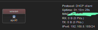

Doesnt work, invalid argument. The correct interface name for WLAN tether/repeater is btw wwan at least for the Mango V2:
config interface ‘wwan’
option proto ‘dhcp’
option classlessroute ‘0’
option metric ‘20’
option ipv6 ‘0’
config interface ‘wan’
option proto ‘dhcp’
option force_link ‘0’
option ipv6 ‘0’
It creates an dev with the name apcli0
