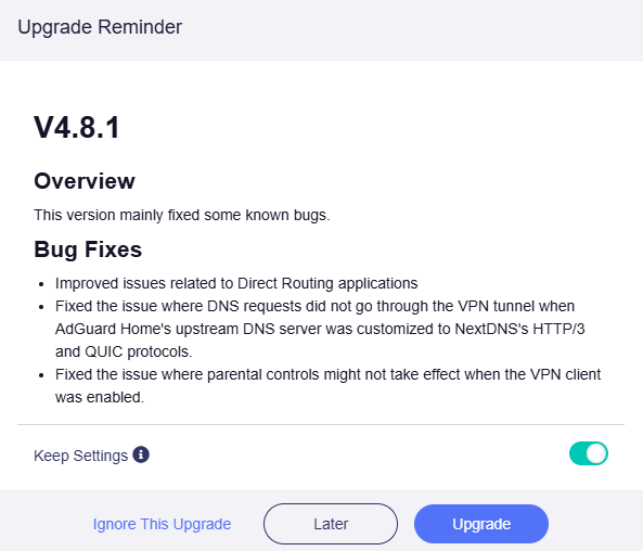

Thanks for the support, will the beta version (4.8.3) gets auto updated to stable (4.8.3) version Once it is release or do I need to anything from my side, because I don’t see the option to auto update button on upgrade page anymore.
We do not automatically update the router’s firmware.
However, once a newer version is released, you’ll see a notification in the Admin Panel indicating that an update is available, along with options to proceed.
You can also download the new firmware from the Download Center and manually install it, just like you did when upgrading to the beta version this time.
