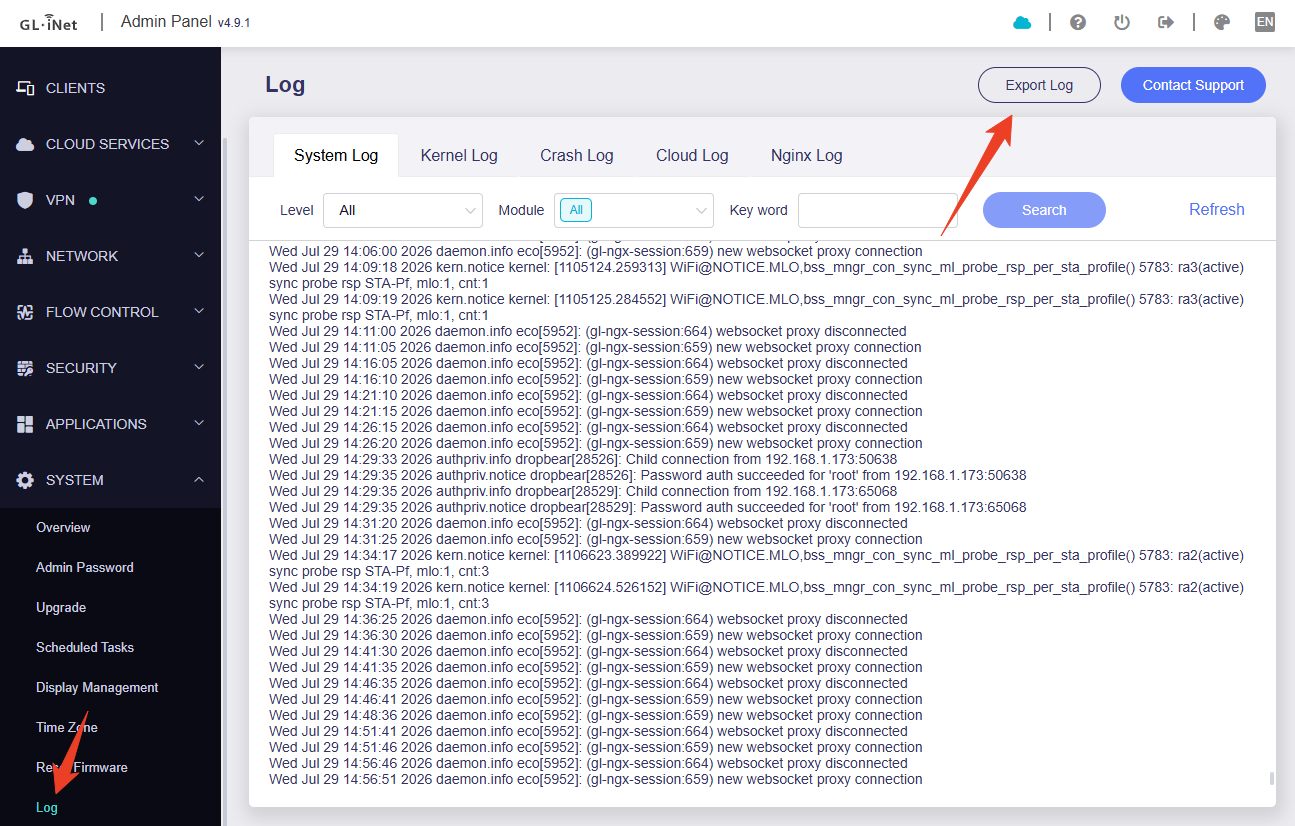

Please provide the logs for the master node and child nodes so that we can investigate further.

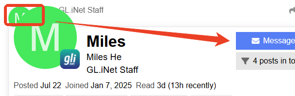

You can provide the logs to us via PM.
