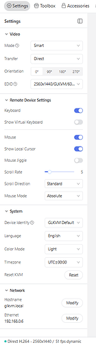

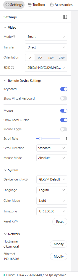

so i go the product with 1.5.x version there i can see speaker and microphone options are available when i try to upgrade that to 1.7.1 the options vanished. May i know the reason
direct h264 don’t support audio
By the way , direct H.264 is not recommended; it is only a fallback mode.
