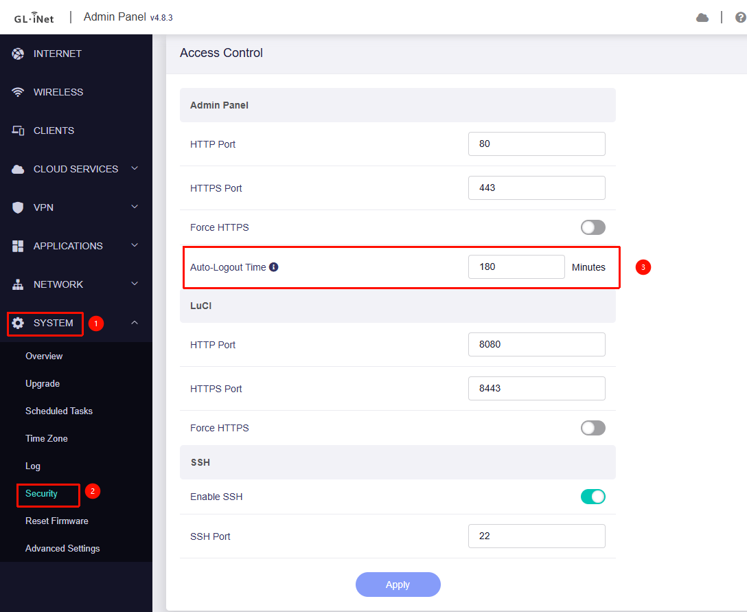

The timeout for the GL UI can be configured under System → Security → Auto-Logout Time.
Could you please confirm the following:
  1. Did you configure it there?
  2. What firmware versions are your MT6000 and BE3600 currently running?

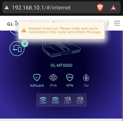

Yes I have set on the GUI as you shown on the photo exactly but unfortunately is not functioning even set it 3 hours and auto logout within a seconds or minutes inactive.

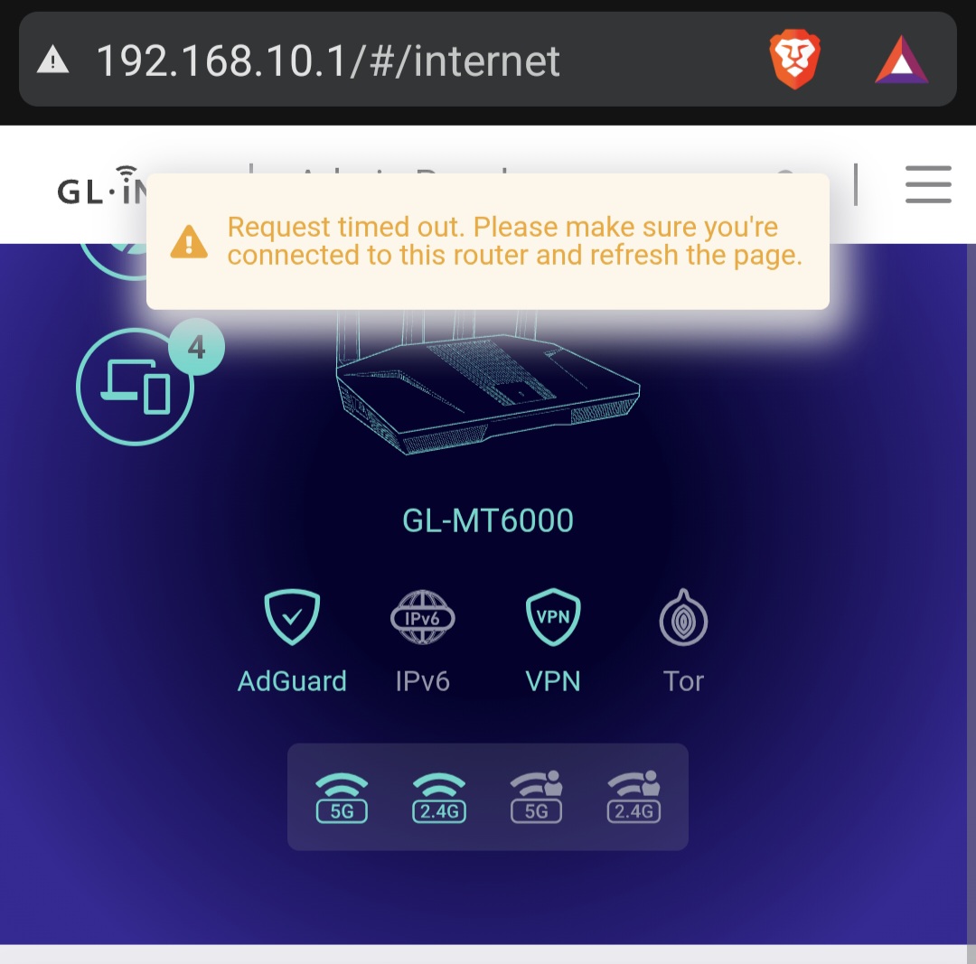

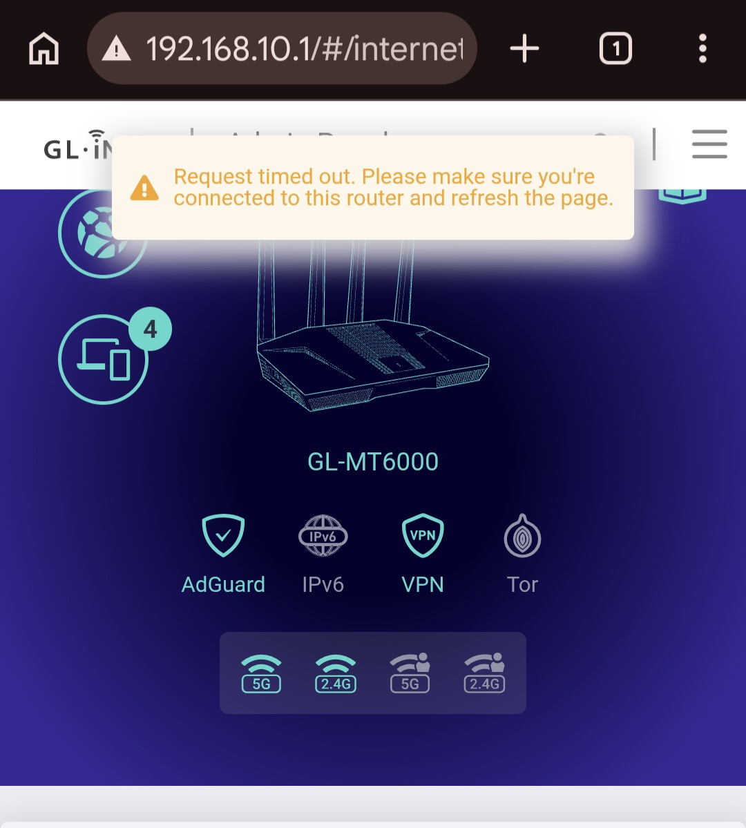

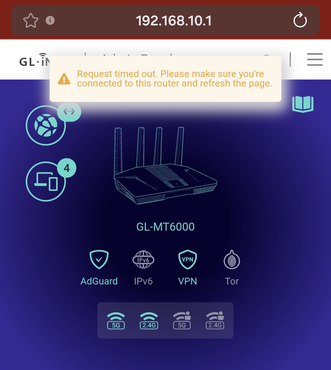

Thanks for your advise and have tested it seems Samsung Browsers got some issue within a minutes auto logout but for Google chrome and Brave Browsers on Samsung phone only error of the warning for inactivity. So the conclusion is Samsung Browers it seem terrible because often used my Samsung phone with Samsung Browers.
