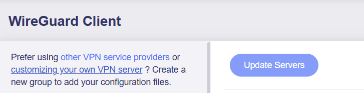

@will.qiu thanks for your update. i do also notice that upon updating the Wireguard servers the VPN profiles losses the VPN connections and forcing us to reselect it. After we reselect the vpn interface numbering (wgclient1 changes to wgclient2 and the same goes to ovpnclient connections.) also gets changed.
Because after click “Update Server”, the original configuration profile no longer exists, it needs to be reselected. This is essentially by design—if the existing profile is still valid, there is no need to update it.
Yes, with the introduction of the multi-VPN feature, different VPN tunnels need to be distinguished, so the interface names will change accordingly.
(Based on the order in which the VPNs are enabled, the first one enabled will be wgclient1, the next will be wgclient2, and so on.)
