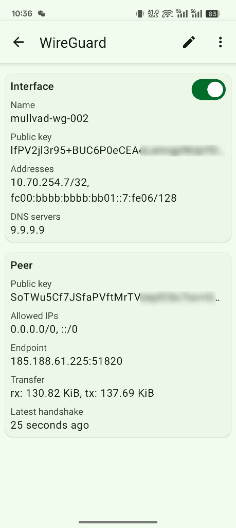

With the vanilla/standard Wireguard app, Mullvad does not hijack any DNS requests on port 53. It honors the “DNS=…” setting from the Wireguard config. All hijacking is done on the client side by the official Mullvad apps.
I just verified this on Android and was able to use Quad9 (9.9.9.9) as my DNS.

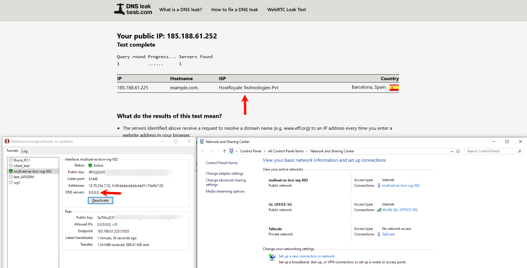

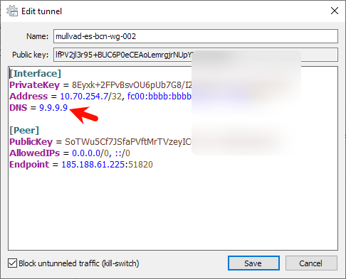

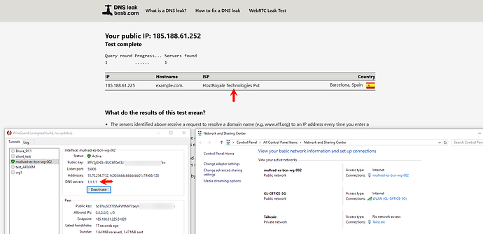

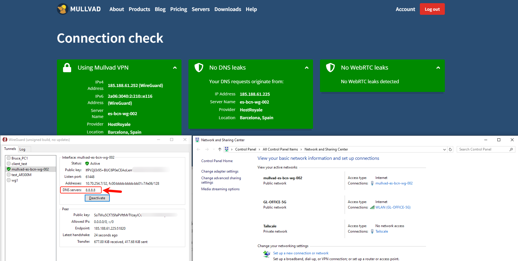

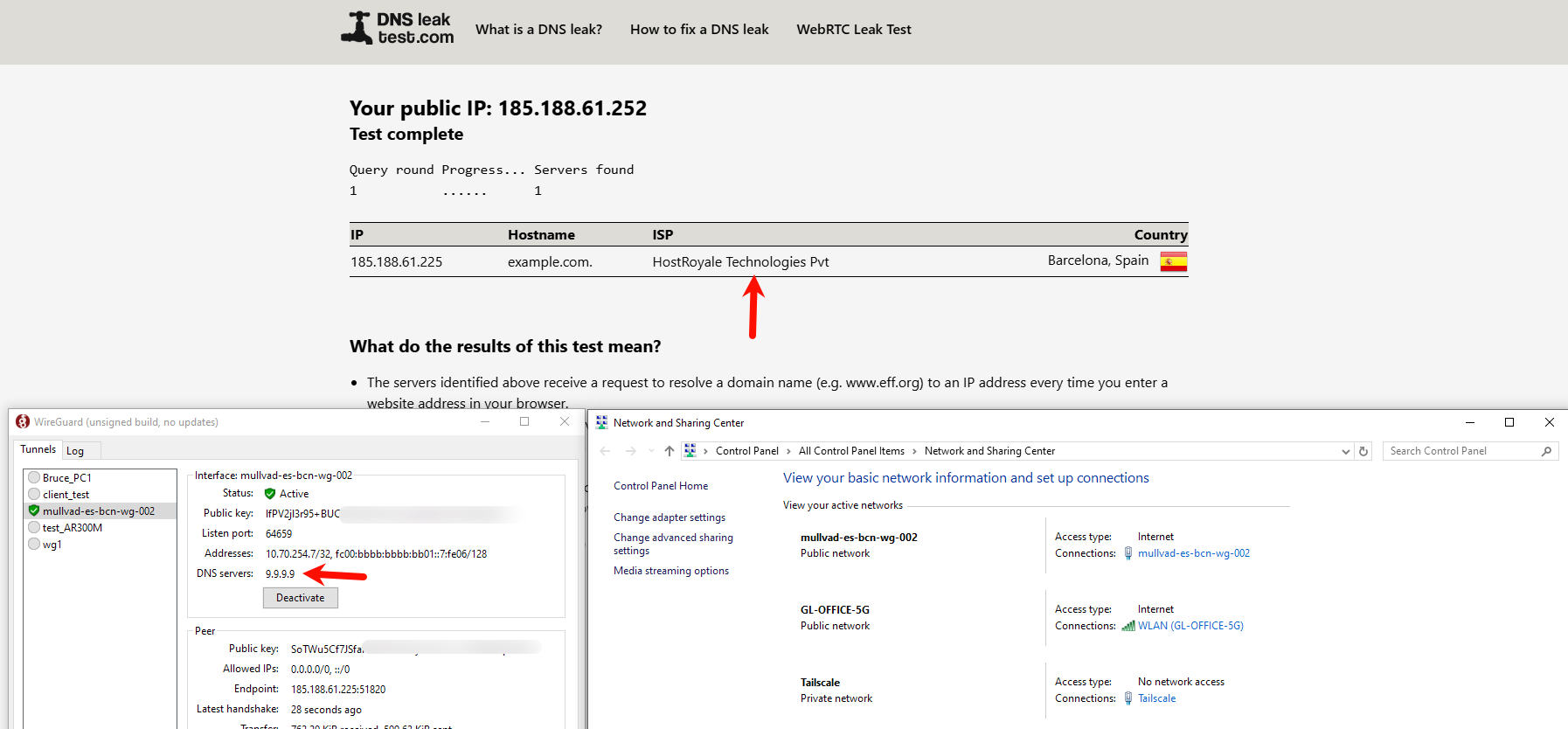

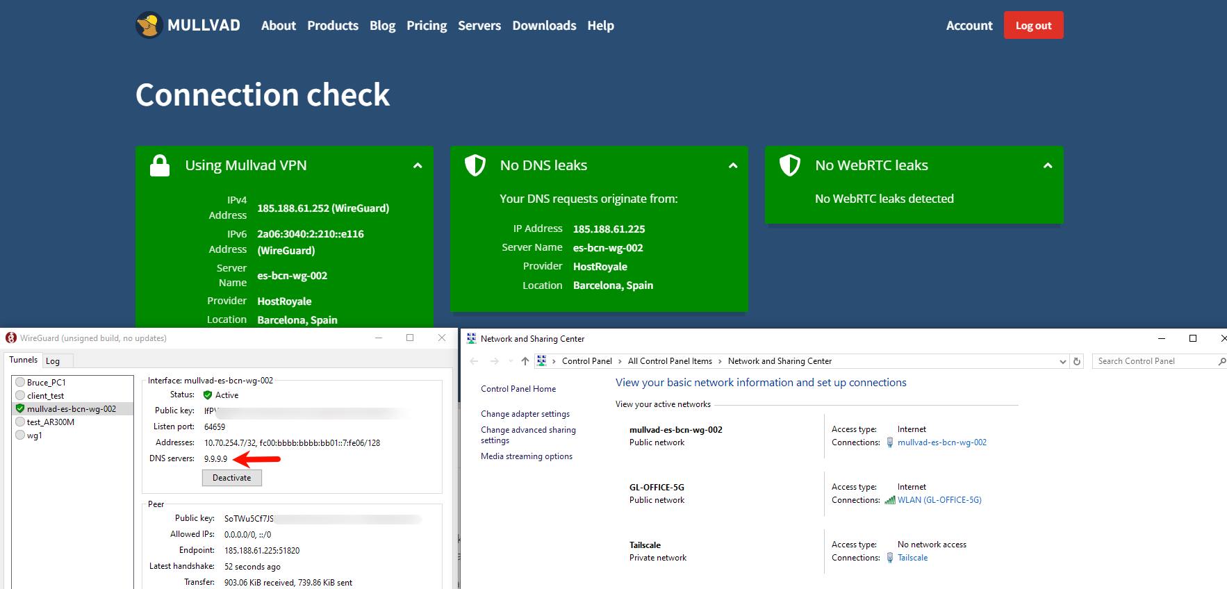

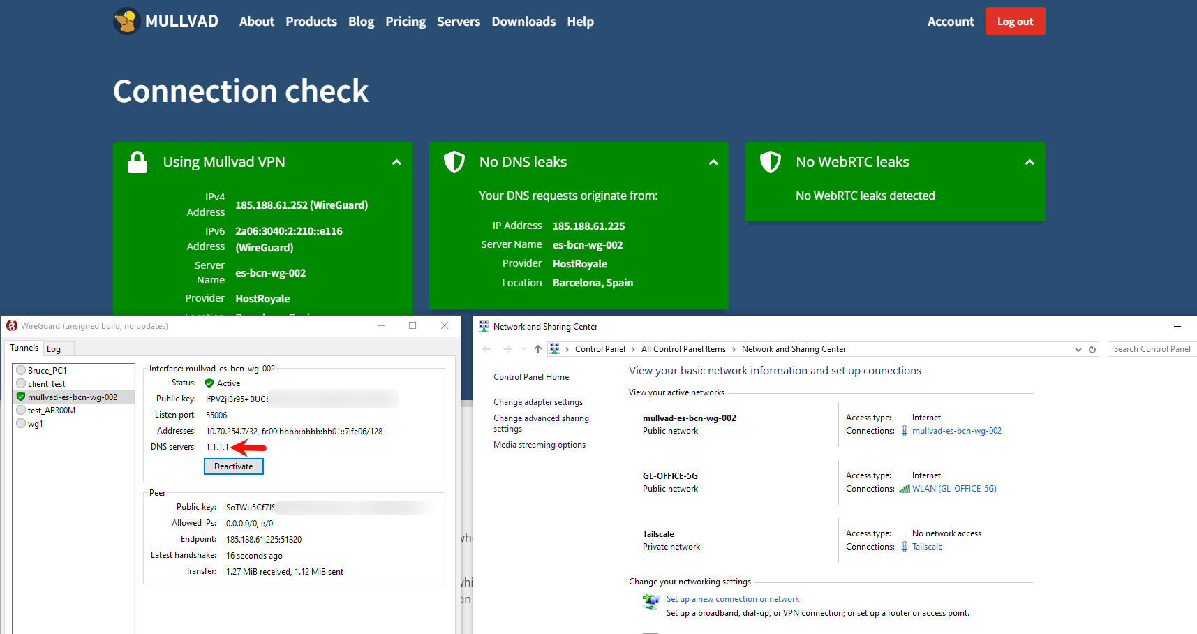

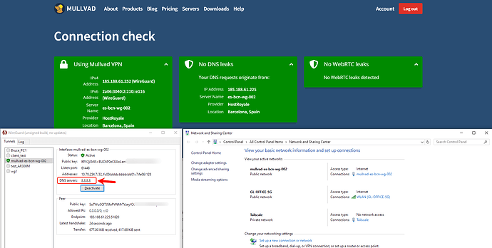

Test on PC WireGuard APP:
Modify to Quad9, but hijacks
Modify to Google, but hijacks
Modify to Cloudflare, but hijacks

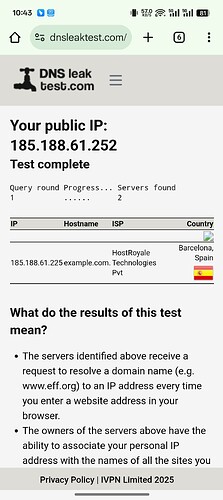

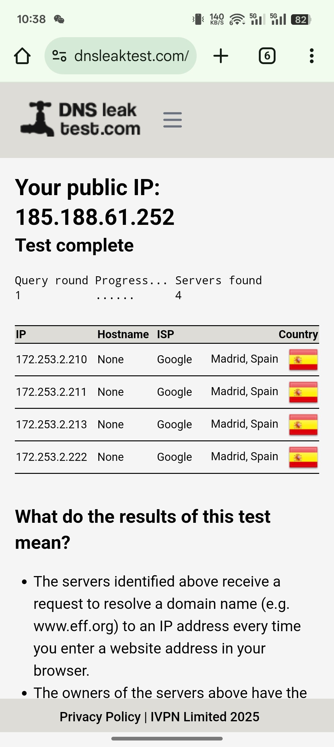

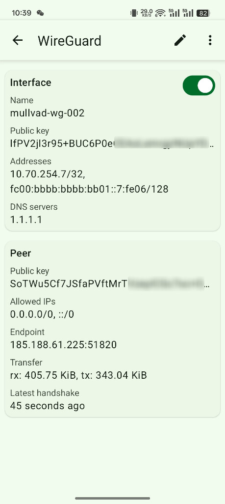

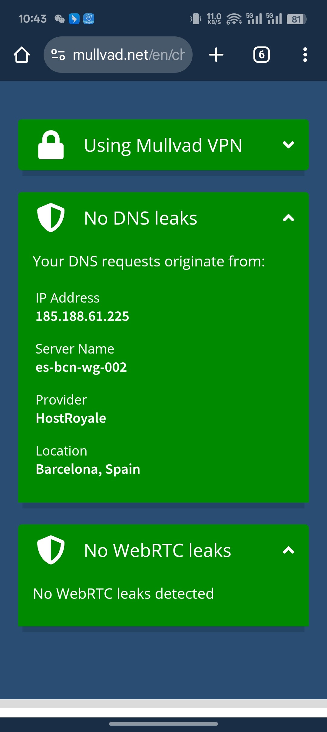

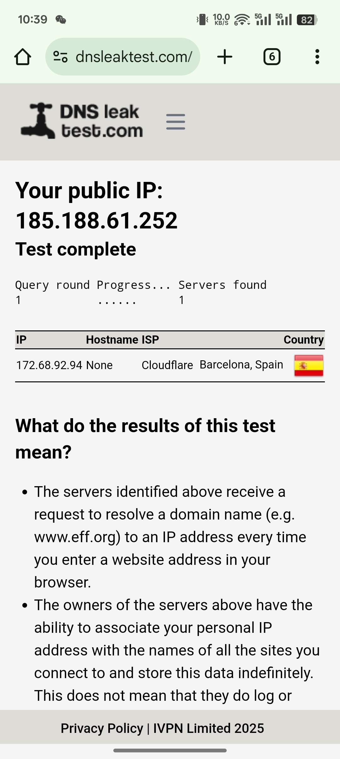

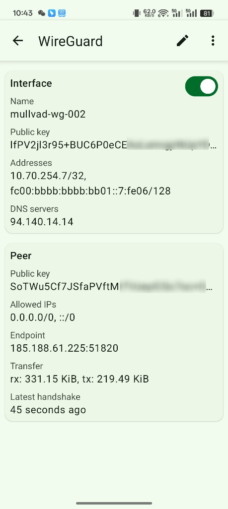

Test on Android WireGuard APP:
Modify to Google, not hijacks:
Modify to Cloudflare, not hijacks:
Modify to ADG DNS, hijacks:
GL router is similar to PC WireGuard, all UDP DNSs are hijacked.

This is very strange. Why would it hijack only some DNS (Quad9, ADG) on Android, but not others (Google, Cloudflare)?
And why would it be different on Windows? The OS dependence suggests it is a client side thing?
And as mentioned, Quad9 was NOT hijacked on my Android.

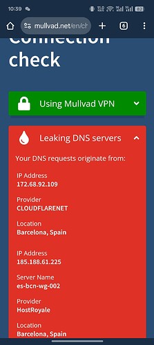

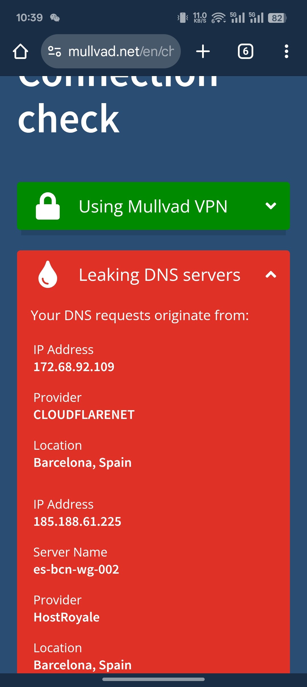

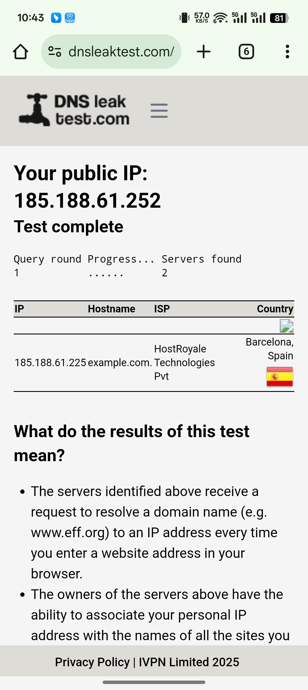

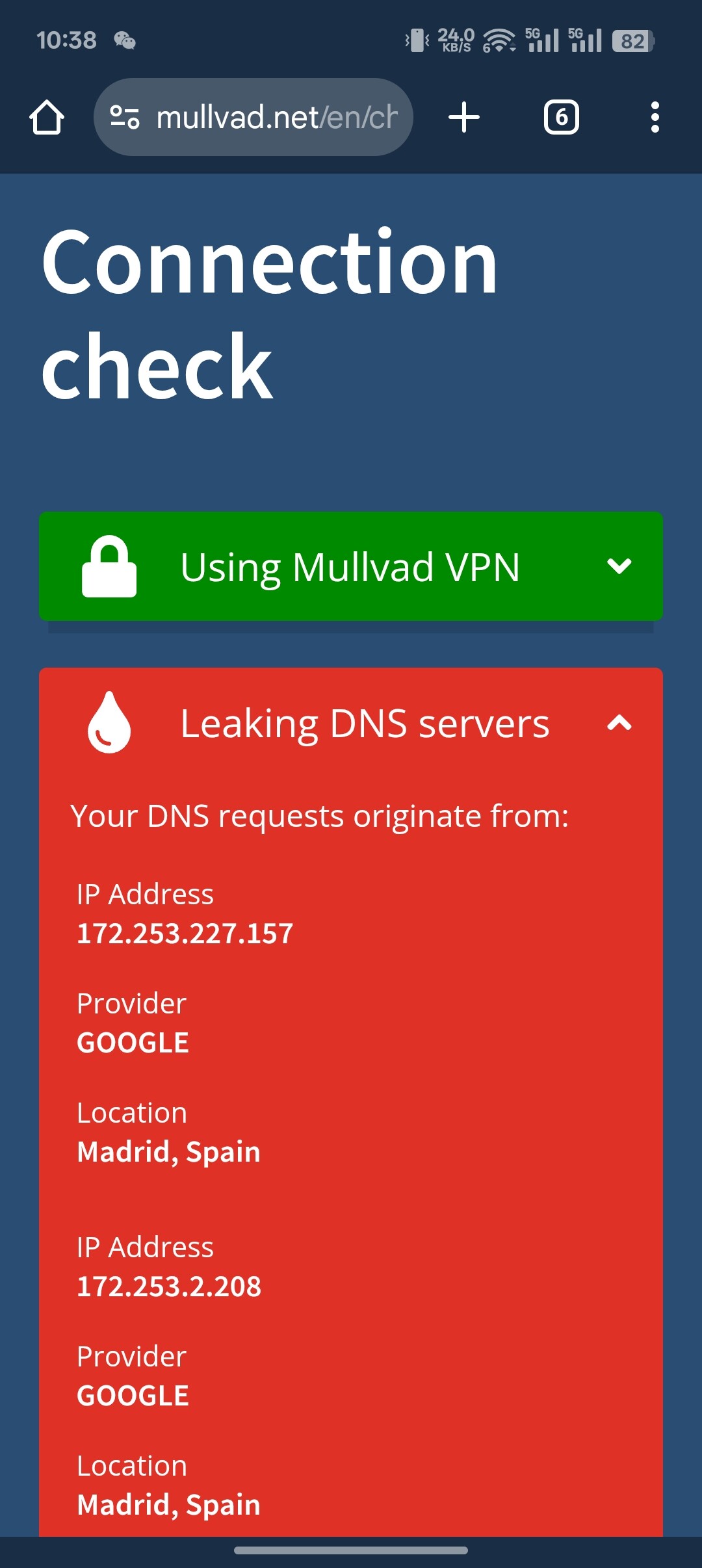

Just tested again on Android.
  • Google => Leak
  • ADG => Leak
  • Quad9 => Leak
  • Cloudflare => Leak
No hijacking.
