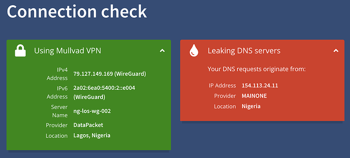

I don’t think this is right. Mullvad works with any DNS server. DNS can be configured in the app. I assume the equivalent in the stock wireguard client is the DNS=… setting.
EDIT: I just tested and saw that my Flint 2 indeed ignores the DNS=… setting in my Mullvad wireguard profiles. However, I think that this is a Flint issue, not a Mullvad/Wireguard limitation.
I'd think the quickest way to confirm that would be to set the conf with DNS = 9.9.9.9. Then check the connection against Quad9's test page/service. If 'no' I'd think Mullvad is successfully intercepting DNS:53. It should be the same result if using a more 'standard' WG client, say, on a phone. That's just off the top of my head.

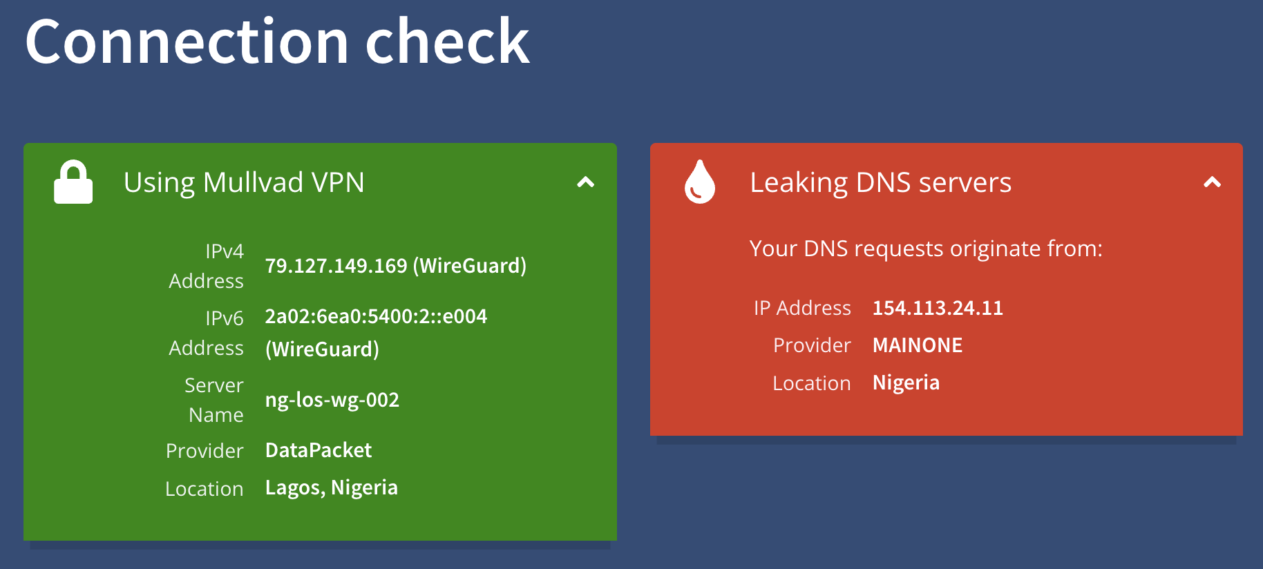

I already did this, and it shows the Mullvad DNS. However, I suspect it’s the Flint intercepting/hijacking the DNS request (or simply ignoring the config in the first place), not the Mullvad network. Because Mullvad does support custom DNS servers.

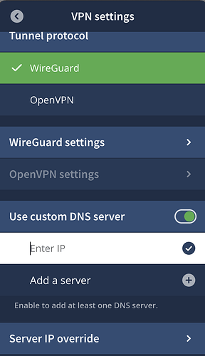

Here is what happens when I set my custom DNS to Quad9 in the Mullvad App:
Did you determine if 154.113.24.11 is apart of Quad9's multicast DNS network?
Well, the default DNS:53 is provided by the dnsmasq daemon. You can see what it has as its default upstream @ grep 'nameserver' /tmp/resolv.conf.d/resolv.conf.auto. Whether the GL customization scripts do anything to a DNS request when wrapped in a VPN tunnel IDK but if you suspect DNS:53 is being intercepted by the Flint v2 itself before hitting the WAN I'd run tcpdump on a device upstream & see what turns up while running in cleartext.
If you get the same results when using a phone & a WG client other than the Mullvad one then you can safely rule out the Flint v2.
All I’m trying to show is that Mullvad supports custom DNS servers. Thus, if Mullvad tunnels on the Flint don’t, then it’s a Flint problem.
You haven't isolated enough variables to make a determination yet.

  1. You are using the Mullvad VPN APP on your phone instead of the official standard WireGuard APP.
  2. On GL routers, the WireGuard client and server are official standard version.
To control variables for comparison, you should install the standard WireGuard APP on your PC/phone and modify the DNS of the Mullvad profile, so that can verify whether Mullvad VPN hijacks UDP DNS of port 53.
