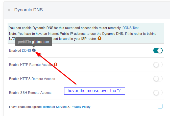

ok we are very close now :wink: I do understand 97% but the last quote is not clear to me:
On your laptop you do ssh -fN -L 4343:192.168.8.200:1234 [email protected]
What machine is this? [email protected]
In general it’s the host name or IP address to reach your AX1800 from whereever you are - most likely its DDNS name or public IP address.
asd123f.glddns.com is the placeholder for your individual DDNS name of your AX1800 (in case you use GL-inets DDNS service it’s sth. like asd123f.glddns.com - on my MT-1300 I find it in WebUI | APPLICATIONS | Remote Access):
Solved! It was so easy with DDNS. It is great! Thank you.
