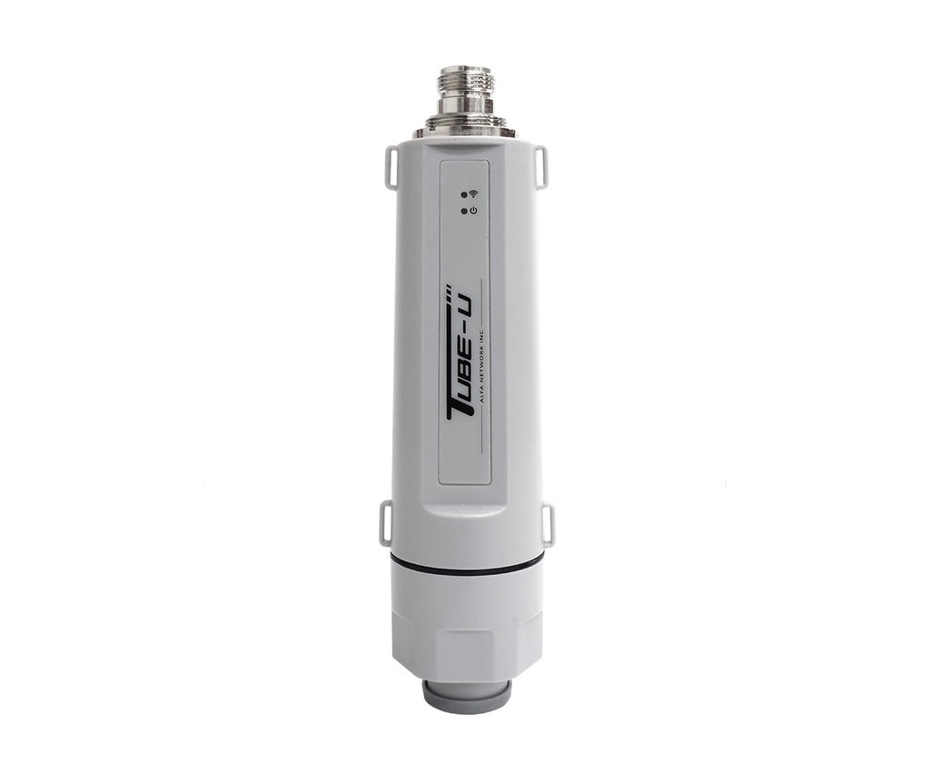

Trying to use a Usb wireless adapter. Adapter is a Alfa Tube-UAC 2. Uses a Ralink RT3070 chipset.
The router doesn’t seem to be recognizing it.

It looks like the Alfa Tube-UAC2 has the Mediatek MT7610U chipset and requires the matching package.
I do not work for and I am not directly associated with GL.iNet
Thanks for noticing that! I had read somewhere that it had a different chip set than that. Also, I ran lsusb and promptly disregarded what it said, apparently.

I’m finally getting back to this project. At this point I’m unable to find a package that supports the Mediatek MT7610U. Am I just missing something again??
Thanks
It appears that there is not drivers for the Mediatek MT7610U chip set. From what I can find, there is if you use the lasted version of OpenWRT. My problem now is that I can’t find where the latest version of OpenWRT is available for the AX1800.
