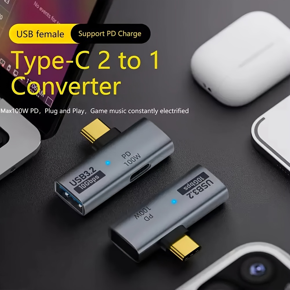

Good news is that you can use an USB C OTG adapter (mine is supporting PD 60W - 5V 3A should be possible if the charger is able to deliver that and usb 3.2 - irrelevant since U50 is usb 2.0) to have the device powered on while tethering over USB. I tested this on a windows pc since my glinet router is not currently powered on or connected and will re-try with the router soon.
When the battery is in the U50 is charging according to the battery light and works relatively well - I have only noticed occasional packet dropped when doing continuous ping to a server on the internet. There is no package drop for a paralel ping to the modem’s LAN interface (the default address for the default gw 192.168.0.1). I didn’t notice if battery is discharging, didn’t keep it plugged in long enough.
When battery is out of the device, it appears to be working while idle with a slowly blinking blue battery light. However when I pull some traffic, e.g. running a speed test the modem would restart about the time it reaches 200Mbs. I am not sure if this is due to the bug you mentioned or because the power supply is too weak. I don’t have an USB power meter around now to check the power consumption, but I will do soon when I am back home.

Which OTG adapter are you using? I have also tested several, but without success. I am currently running the U50 with a battery on a power supply and connecting the U50 and the GL-iNet router via Wi-Fi. Therefore, the adapter would help me a lot.

This is the one I found in my cables bag and tested with U50.
Thanks! :slight_smile:
