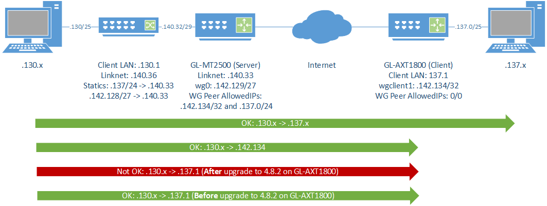

Is your topology like this?

Hi Bruce,
Seems you are mostly correct, however my issue was reaching the LAN interface of the AXT1800, not the WAN.
In my case:
  • PC_A can reach PC_B
  • PC_A can't reach LAN IP of the AXT1800 in your drawing, typically 192.168.48.1

Without a topology diagram, I have a little bit of a distinction between the IPs of your network.
I think you would draw a topology diagram similar to mine above.

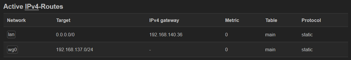

In your Luci screenshot, there is no gateway IP for the wg route,maybe fill in the tunnel IP of the VPN client.
My topo matches you drawing and I am so extremely short on time these days so have not had time to draw up something. Only things extra are another hop on my server side as will as different IP addresses of course.
True but that is how it has always been and it always worked fine and still does towards other clients, both software and other hardware units from GL. These routes are also automatically generated by WG, not something I have needed to do manually.

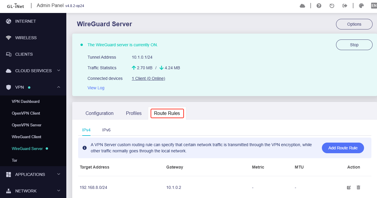

@bruce This is relevant parts of my setup which changed after upgrading the GL-AXT1800, it is also the only device which had any changes.
