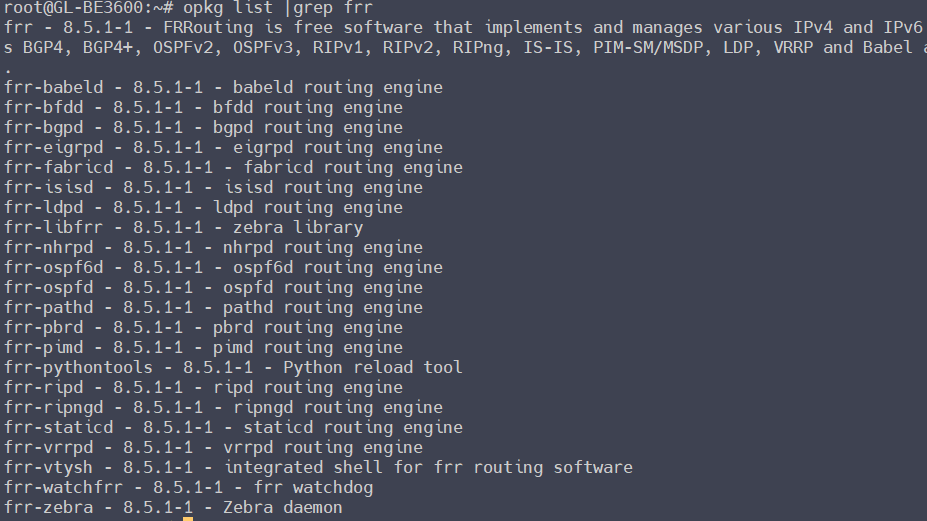

Loathe to upgrade my MT3000 to 4.7.13, is FRR available in the repos for that as that is is reliant on dynamic routing to operate?
Simon
bruce
June 20, 2025, 8:45am
11

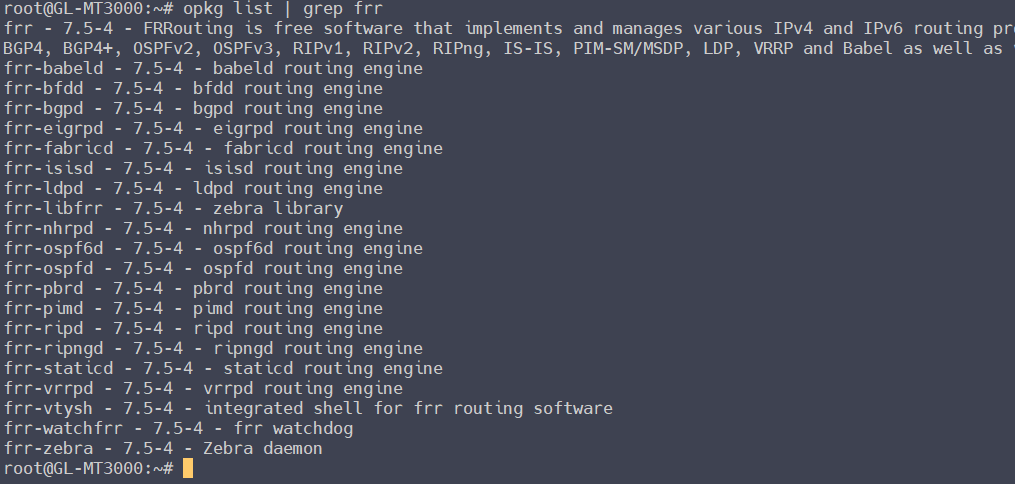

the MT3000 repo has frr.
But the MT3000 latest firmware version is v4.7.4 stable, or 4.8.0 beta/snapshot, not v4.7.13.
Did you mean v4.7.13 for the BE3600?

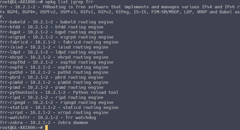

AXT1800 v4.8.0 has not found frr, will ask R&D to check it again.
Update:
AX1800/AXT1800 repo now has frr in latest firmware v4.8:
