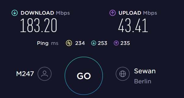

Here is my setup:
  • Main router to ISP modem
  • AX1800 repeater to Main router
  • AXT1800 cable to AX1800
  • My pc cable to AXT1800
ON AX1800 I am using Azirevpn
On AXT1800 I am using Proton
I can do speedtest and access various website
The setup is not ideal for general use becasue too complicated but seems it works.
