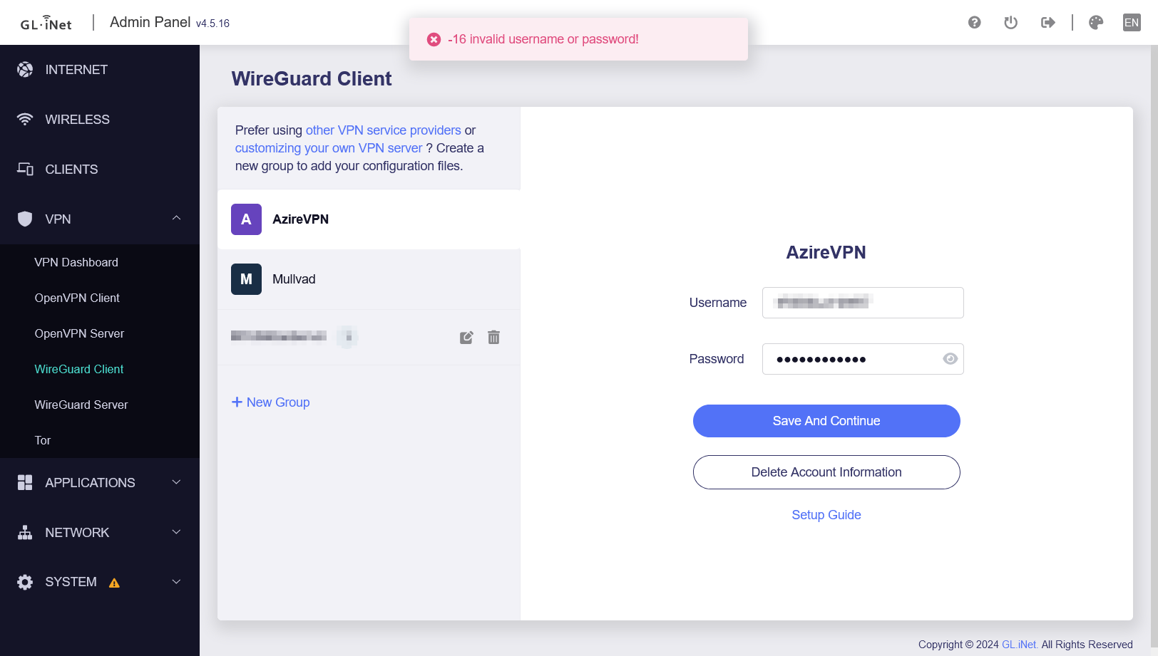

AzireVPN on AX1800 and MT6000 login fail
I tried to login with my AzireVPN account and it failed as shown in the attached screenshot, on both AX1800 and MT6000, from the WireGuard client page - AzireVPN.
On MT6000, if I remember correctly, when AzireVPN trial was given away from gl-inet, I tried it successfully back then. But never tried on AX1800.
Login credentials are working on mobile devices.
I just copied and pasted from password manager.
Password contains symbols like # $ etc.
I found a post on gl-inet forums from 2019 with probably the same issue but it was resolved by installing a bug-fixed gl-wg app, which is not found on the latest firmware versions on both my devices.
Kindly requesting assistance.
In the screenshot, the System Tab has a yellow triangle because I am remoting into AX1800 in another country in another timezone, however, MT6000, also having same issue, is right in front of me, so please disregard that yellow triangle.
Edit:I have also deleted existing tokens from my AzireVPN account already where only currently active tokens are present as of now.
